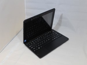

The Acer One 10 S1003-114M is a convertable, allowing it to function as a tablet as wall as a laptop.
Power on and off immediately
I installed windows 10 after installation, when powered on, it just blink light and off, it starts getting hot immediately. What should I do?

It’s a security measurement, when the CPU overheats the PC immediately shut down to prevent further damage, so you need to :
  • Check your fan if it spins or not
  • Clean the radiator (remove dust)
  • Make sure there is nothing on the airflow path (intake & exhaust)

I have removed all cables and reinstalled all but it can't start without switching on button it is starting automatically and turning off in a second

I don't think it has anything to do with the W10 install. Sounds like the CPU might have shorted out. It happened to me once.
It might be possible to remove the CPU and power on to verify it stays on with the CPU removed. However, that could be a tricky process.
