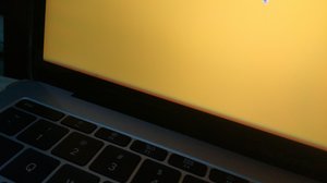

Horizontal line on bottom of MacBook Pro 2017 (Due to overheating)
Hey everyone,
Long story short- I share my laptop with my room mate. My room mate confessed to me that she was using the laptop on her bed, over the sheets with the power adapter plugged in. She said that the machine got really loud (I guess the fans or whatever were going off)
It overheated.
Later that day I noticed that there was a black line below the app menu on the bottom. It was weird because I would move the cursor over it and you could see the cursor. I have ran NVRAM and SMC and it hasn’t fixed the issue.
However, we left it shut down over night and it was ALMOST completely faded in the morning (though with use the lines would eventually come creeping somewhat back but not as bad as the first day.)
I don’t want to be super hasty and assume I am in for a $500 repair. I have seen similar posts on here where people had the same issue and they said that the lines eventually went away, or that after a week of not using the laptop they got lucky.
Has anyone gone through this? Is this something that will get worse over time?
Is it possible the over heating caused one of the cables to come loose inside the computer? I was thinking of opening up the laptop and reseating the display cables.
Does it ACTUALLY need a replacement or is this something that will go away with time/can be solved by opening up the macbook or leaving it off for a while.
As is the case with most people, I don’t have the money at the moment to handle what would probably be an expensive repair.
I would complain about how the computer is only two years old but I am pretty sure its my room mates fault for the overheating lol.
If any of you have any suggestions or similar experiences I would really appreciate it.

Can you post a picture so we can see what you are seeing 在已经存在的问题里加入图片
Until we get an idea on what you are facing I would hold off opening your system as you could make things worse!
I'm not sure where you saw lines fading in and out here. I don't remember seeing anything here on iFixit.
Often times lines are TAB connection issues when the mounting of the flex ribbon to the LCD panel has broken free. Often due to a bang or something heavy sat on the lid.
The other possibility is image persistence (image burn-in) where the LCD crystals have fatigued from being held active overly long. There are some tricks that might reduce the effect.
The pictures will help us understand which one.

OK, this is a very different kind of problem than what I was expecting. The LCD display panel its self does not have any problems! This is a heat issue with the T-CON board.
Let me explain … The T-CON board is mounted just above the heatsink radiator within the main case unlike the older MacBook Pro’s which had it mounted within the lid with the LCD display panel.
So when you blocked the ventilation the board overheated causing it to loose its horizontal sync at the bottom edge of the display giving you this colorful line.
This board is part of the display assembly so if it does get damaged from overheating you’ll need to get the full assembly replaced which would be an expensive repair!
So you are lucky! The overheating didn’t damage anything as it did recover. So lesson learned, don’t block the ventilation and keep the fans clean and don’t block the vents! ;-}

@Not A Doctor, Shh & @Seff Ka - The backlight repair is for the stage-light effect due to the backlight ribbon cable being too short so its stressed here's more on it: The Design Flaw Behind MacBook Pro’s “Stage Light” Effect
This is a very different issue! The black bars (top or bottom) is due to over and under-scanning of the LCD panel (you'll also often see the menu bar text be compressed).
This is the job of the T-CON to pump the LCD with the needed data to set the pixels on and off as well as the correct color. Timing is critical here! It's this timing logic within the T-CON board that drifts due to heat!

Hello dan and bruce. Right now I'm having same problem about my macbook pro 2017 13inch. My macbook did have some line in bottom if its had overheating. But if my macbook in normal temperature it disappeared. Here is my question, did your macbook runs well without any problem? If its runs well, i hope you give me solution my macbook. Please:(
This is in normal
This is the problem

Sadly, the solution is a new display assembly, there is no other option.
