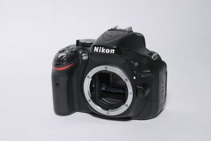

How do I fix a broken articulating screen?
https://imgur.com/a/Y63i3
'I just broke my articulating screen of Nikon D5200. It fell off while on a tripod towards the screen that was flipped out and the screen broke. I can still take photos and the display is not damaged by the flip screen is broken and cannot adjust it. HELP!!!

Hi,
You may have to replace the camera's back cover case,
Here is a link to just one supplier. It is not a recommendation to use them. It is shown t give an idea of the cost of the part. There are others available online that may suit you better.
Here is a link to the ifixit Nikon D5200 Motherboard Or Camera Back Replacement guide to help you with the repair/replacement (if this is what you decide to do). You only need to go to Step 7. in the guide.
Hopefully this is of some help
