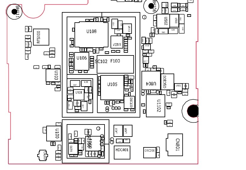

Update: Jayeff's answer moved me one step closer: On this diagram somewhere is the wifi circuitry. Can anyone point out exactly which I need to sever, I believe it is one of the 5 sections of the large 5 section frame?

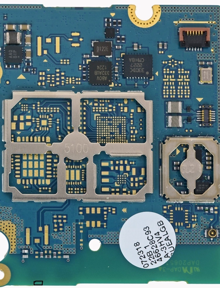

If you look at the photo (https://d3nevzfk7ii3be.cloudfront.net/ig...) the link is on the other side of the board. I marked to position with the black box.
You can see the connections/wiring in the diagram. Any idea which is the wifi?

I know I'm old but I cannot see anything near the black box that you marked, I am wondering however that as there is seemingly nothing (no components under the 5 section frame, that is unless it is directly under the middle or the arms of the 5 frame bracket marked 5100 on the board) BUT there are two components under the 2 section frame AND it is also close to the GPS antenna input socket I'm now wondering if you could check the numbers on those two IC type components (as I cannot make it out at all even when trying to magnify it) and see if the come up as a GPS module and a WiFi module - hopefully.

The connection is on the other side of the board. I put the black box there to mark where the antenna connection is on the reverse side of the board.
I'm pretty sure that, while wifi and BT are on the same chip/circuit, GPS is separate.
This is the diagram of that part of the board: https://d3nevzfk7ii3be.cloudfront.net/ig...
I still haven't figure which is wifi/bt...

Jayeff, looks like it's U202, which is at the opposite end of the board https://d3nevzfk7ii3be.cloudfront.net/ig...
I plan to cut the connection showing the red line in the bottom left corner. Does that look right (I should lose wlan and BT)?

At a quick glance it looks about right. Cut it (use a razor cutting blade as the tracks are only thin) in such a way that if you are wrong that you can "bridge" it with a soldered strap back again. Also you could try just cutting the power input lead to the IC and see if that works if the antenna "cut" doesn't work.
