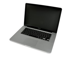

change the komplete keyboard in a MacBook Pro 5.1
I have to clean my keyboard because of an "drown in a drink" accidesnt ...
what can I do ?

I bought mine from [www.thebookyard.com|The Book Yard UK]. They have 4 variations of the keyboard - US, UK, SWE and INT.
I would say to browse under the original MBP since you're using the 5,1 as I am, look for the keyboard which matches yours. At least thats what I did, and it works perfect.
But the screws, be prepared for 49 mini screws for the keyboard, and about a million others just to get to it.
In order:
  • Screwed on
    1. take out the logic board
    2. take out super drive
  • Glued on
    1. plastic holding LED - stuck to casing
    2. Diffuser panel - stuck to keyboard
(I ran a spudger along the stuck down parts to loosen them up rather than forcefully pull the pieces off)
  • screws again
    1. Take out the 2 screws which hold on to the power button
    2. the 49 screws others holding the keyboard down between every other key *aargh*
That should get your keyboard out. Just reverse the order to put it back, and If you really want to get the LED and diffuser panel to stick back then i suppose just use super glue.
