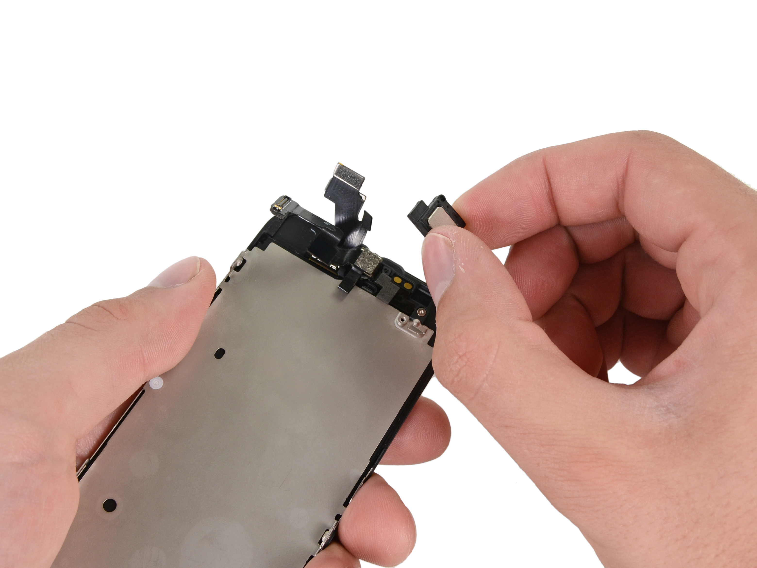

Hi iFixit,
I did a screen replacement on an iPhone 5. Screen worked great but unfortunately I couln't hear people anymore while calling. I guessed the ear speaker was broken so I ordered a new part: http://d3nevzfk7ii3be.cloudfront.net/igi...
I replaced the ear speaker but still no improvements: I can only call on speaker.
Is any one familiar with this problem? Did I forgot a connector or something?
Thanks for your time!

Just fixed this same problem. I had replaced the lcd screen on an iphone 5 and the earpiece didnt work after. Heres how i fixed it. I went back over all of the ribbon connectors to make sure they are all seated well. That didnt fix it, so i took the earpiece off and cleaned the two copper contacts (attached to camera's ribbon connector that the earpiece prongs make contact with. After cleaning them with my contact cleaner pen i made sure they were properly aligned so they earpiece prongs would be touching them. Then when i went to reassemble i flipped over the 3 ribbon connectors and blew them out to make sure there was no dust or debre hendering there contacts. Reassembled and it worked fine. Not sure which of those three steps did it but you might as well do them all while your in there. Hope it works out for everyone else like it did for me.

Great Jason, nice to see that the cleaning worked for you. I finally managed to fix my problem as well, however the cleaning didn't help. It took me almost 4 months to understand what was wrong. I'll explain the best i can.
This was my problem and solution:
The prongs underneath the actual earpiece is only supposed to touch the copper plates, not actually that much force, if they are pushed too hard, it will not work.
So i got an original screen and found that when i disassembled it there were two very very small plastic squares with hole in them(for the screws), and is working to keep a good distance for the screws(so they are not screwed all the way into the bottom).
As i ordered my new earpiece and flex cable these small plastic squares were not included. So without them the screws were reaching the bottom and pressing the earpiece too far down and the prongs were too hard against the copper plates. So it should be firm with a loose fit(that the plastic squares solves). I guess if you lost these plastic squares you could probably improvise, but there is no way to order these parts(as to what i have found yet).
A good tip is to take an old broken screen from someone and use the plastic parts from that earpiece to yours if you lost them.
This was one tricky thing to figure out, since none else have seemed to explain a good solution. I hope i made it clear with the explaining part, if not please respond and i will explain further.

Andreas - did you add a comment to the pertinent part of the Guide? Anyone can do that.
完成的
do you possibly have a picture of those plastic parts?
完成的
Okey, i machead3, i didn't know that at the time, so no.
Someone has apparantly fixed the guide so it includes this part. Just to make everything clear it's step 14 of this guide for the earpiece.
Picture: https://d3nevzfk7ii3be.cloudfront.net/ig...
Guide: iPhone 5 耳机扬声器替换
Without this plastic part you won't hear a thing.

The problem with picture 14 of the guide is I don't see anything that looks like that.
It should also be in an earlier step as a warning before you lose the piece.
A less-close image would be helpful to show where we are looking and then getting to the detail.
完成的
For the not so unlikely case this plastic squares have been lost ... how thick does the spacer need to be? (I'm thinking of replacing it a plain shim metal/plastic).

i had the same problem but i found a way to fix mine. i took the speaker out and realized that one of the copper springs wasnt straight and it was bent to the side, and wasnt connected. so i straighten it out and made sure it was connected, i put everything back and it worked perfect.
if u look at the picture the one is his hand is the earpiece speakers, and to the left of it is two copper recievers? i believe is wat its called. they need to be fully connected for the sound to work
I hope I was of help.

I only loosened the two screws holding the speaker and without those plastic parts it works.
I'm not sure how long will it work for but right now it dose work!

My issue was static noise on top of voice from caller rather than no sound at all.
My solution was to loosen the 2 screws, that hold the earpiece( https://d3nevzfk7ii3be.cloudfront.net/ig...) in place. The screw that I believe made the most difference is the longer screw that tightens to tiny plastic spacer closest to the camera. I loosen that screw to almost half to 3/4 turn before it "pops" out. I made sure the earpiece is as level to the overall plane and not slanted (cos' by over tightening).
Put everything back together and it works perfect now!
Hope this helps!
