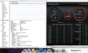

I fitted a Samsung EVO 860 mSATA using the adapter mentioned in some of the comments here. Thanks for all the information, I will be upgrading my own 2012 Retina to a 1TB Samsung EVO 860 mSATA soon.
Here are some pictures of Blackmagic Disk Speed Test from the old and new SSD.

2条评论:
Please share update of your results of this effort. Thank you.
完成的
Hi, thanks for share this captures, please can you tell me if you need update the SSD's firmware after install the SO ? thank you!
完成的
