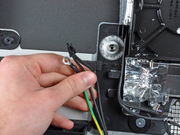

  36. iMac Intel 21.5" EMC 2308 AC Inlet Replacement, AC Inlet: 步骤 36 中的图像 1,1
    • Remove three T8 Torx screws securing the AC inlet to the outer case.
  37. iMac Intel 21.5" EMC 2308 AC Inlet Replacement: 步骤 37 中的图像 1,1
    • Peel the pieces of EMI tape securing the AC inlet to the outer case.
  38. iMac Intel 21.5" EMC 2308 AC Inlet Replacement: 步骤 38 中的图像 1,2 iMac Intel 21.5" EMC 2308 AC Inlet Replacement: 步骤 38 中的图像 2,2
    • Use a nut driver to remove the 5 mm Hex standoff securing the ground loop AC inlet cable to the outer case.
    • De-route the AC-in and ground cables from the clips in the outer case.
    • Remove the AC inlet from the outer case.
