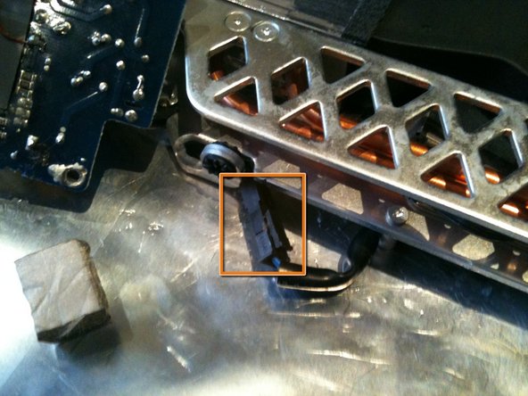

    • Locate the black cable that runs from the right side (input) of the powers supply under the metal frame. Using a rounded (not sharp) tool gently bring the cable out from under the metal frame
  25. iMac Intel 20" EMC 2105 and 2118 Power Supply - short cut method avoids removing logic board Replacement: 步骤 25 中的图像 1,2 iMac Intel 20" EMC 2105 and 2118 Power Supply - short cut method avoids removing logic board Replacement: 步骤 25 中的图像 2,2
    • You should now remove the metalised foam block located under the metal frame near the top HDD mount. Then GENTLY pull the wires out from under the metal frame to expose the connector
    • I used an Allen key as a hook to do this. The wires may be secured with tape. If so use a spudger or other non sharp tool to lift or break the tape to free the wires
    • The wires from the power supply to the connector are JUST long enough to allow disconnecting the connector. REMEMBER this when you install new Power supply to avoid damaging it
