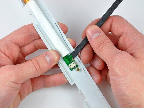

    3. iBook G3 14" Front Display Bezel Replacement: 步骤 42 中的图像 1,3 iBook G3 14" Front Display Bezel Replacement: 步骤 42 中的图像 2,3 iBook G3 14" Front Display Bezel Replacement: 步骤 42 中的图像 3,3
      • Insert the flat end of a spudger into the gap between the front and rear bezels.
      • Rotate your spudger until it is parallel to the front face of the display.
      • Run the spudger around the perimeter of the display to separate the rear bezel from its retaining clips.

    7. iBook G3 14" Front Display Bezel Replacement: 步骤 61 中的图像 1,1
      • Use the flat end of a spudger to remove the antenna board from the front bezel.
      • The antenna board is very thin and delicate.
