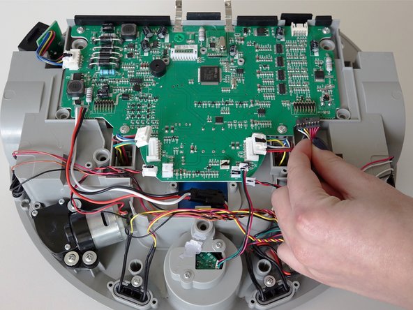

  7. bObi Pet Main Board Replacement, Disconnect All Circuit Plugs: 步骤 7 中的图像 1,3 bObi Pet Main Board Replacement, Disconnect All Circuit Plugs: 步骤 7 中的图像 2,3 bObi Pet Main Board Replacement, Disconnect All Circuit Plugs: 步骤 7 中的图像 3,3
    • To remove the old mainboard, disconnect the 7 circuit plugs on its surface.
    • There are 5 at the front of bObi Pet, near the front wheel.
    • Plus one black circuit plug near bObi Pet's left wheel.
    • Unplug the power switch near bObi Pet's back.
    • Finally, disconnect the battery, located on top of the main board

  12. bObi Pet Main Board Replacement: 步骤 12 中的图像 1,3 bObi Pet Main Board Replacement: 步骤 12 中的图像 2,3 bObi Pet Main Board Replacement: 步骤 12 中的图像 3,3
    • Reattach all the circuit plugs correctly. There are five at the top, one black circuit plug on Bobi Pet’s left, and the circuit plug for the power switch on Bobi Pet’s right.
    • Tuck any protruding wires into the crevices around the mainboard so the lid can easily sit on top.
