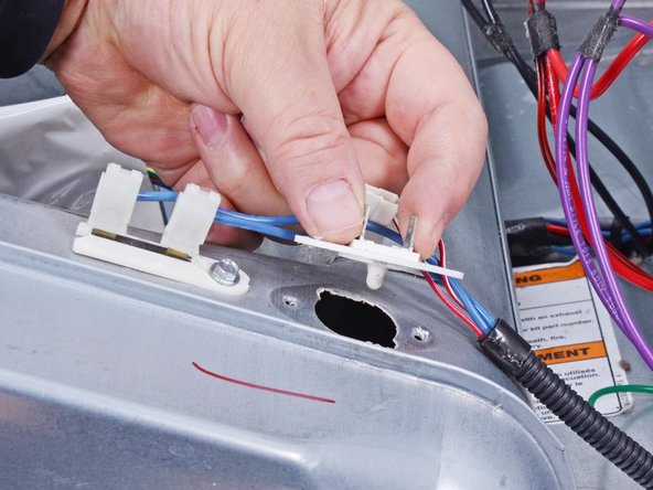

  41. Whirlpool Dryer Outlet Thermistor Testing and Replacement, Outlet thermistor information: 步骤 41 中的图像 1,2 Whirlpool Dryer Outlet Thermistor Testing and Replacement, Outlet thermistor information: 步骤 41 中的图像 2,2
    • The following steps will show how to test and replace the outlet thermistor.
  42. Whirlpool Dryer Outlet Thermistor Testing and Replacement, Disconnect the outlet thermistor: 步骤 42 中的图像 1,3 Whirlpool Dryer Outlet Thermistor Testing and Replacement, Disconnect the outlet thermistor: 步骤 42 中的图像 2,3 Whirlpool Dryer Outlet Thermistor Testing and Replacement, Disconnect the outlet thermistor: 步骤 42 中的图像 3,3
    • Disconnect the two spade connectors attached to the outlet thermistor.
    • Make sure to grip the connectors, not the wires when disconnecting them.
  43. Whirlpool Dryer Outlet Thermistor Testing and Replacement, Testing the outlet thermistor: 步骤 43 中的图像 1,1
    • If you aren't sure how to use a multimeter, take a look at this guide.
    • Set your multimeter to the ohms (Ω) setting. If your meter has more than one scale for ohms (Ω), set it to (Rx1000).
    • Touch the probes to the contacts on the thermistor. The reading at room temperature (70°F/21°C) should be about 12.5–14.5 kΩ for a Whirlpool Duet dryer;
    • Other models may have different values; 10 kΩ is common at room temperature (70°F/21°C) for another outlet thermistor (also called temperature control thermistor).
    • If your thermistor reads outside the proper range or reads no continuity (OL) or 0.00 Ω, follow the next steps to replace it.
  44. Whirlpool Dryer Outlet Thermistor Testing and Replacement, Unfasten the thermistor: 步骤 44 中的图像 1,1
    • Remove the mounting screws securing the outlet thermistor to the blower housing.
  45. Whirlpool Dryer Outlet Thermistor Testing and Replacement, Remove the thermistor: 步骤 45 中的图像 1,2 Whirlpool Dryer Outlet Thermistor Testing and Replacement, Remove the thermistor: 步骤 45 中的图像 2,2
    • Remove the outlet thermistor from its mounting hole by lifting it straight out.
