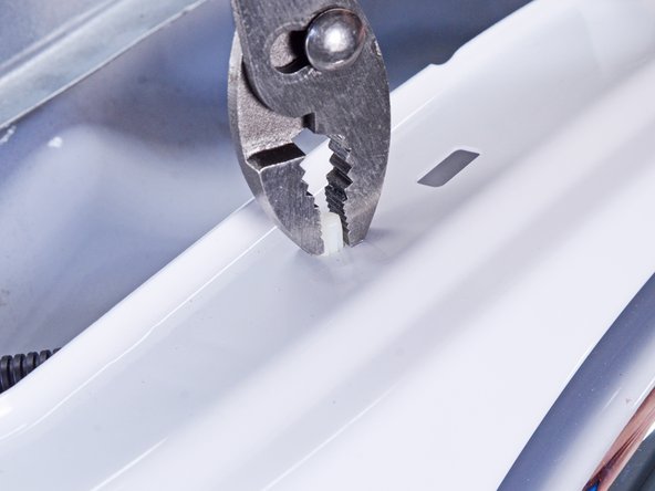

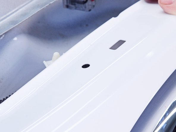

  13. Whirlpool Dryer Door Switch Testing and Replacement, Release the door switch harness: 步骤 13 中的图像 1,3 Whirlpool Dryer Door Switch Testing and Replacement, Release the door switch harness: 步骤 13 中的图像 2,3 Whirlpool Dryer Door Switch Testing and Replacement, Release the door switch harness: 步骤 13 中的图像 3,3
    • Use slip joint pliers to pinch the tabs of the harness clip.
    • Push the clip through the mounting hole to release the door switch harness.

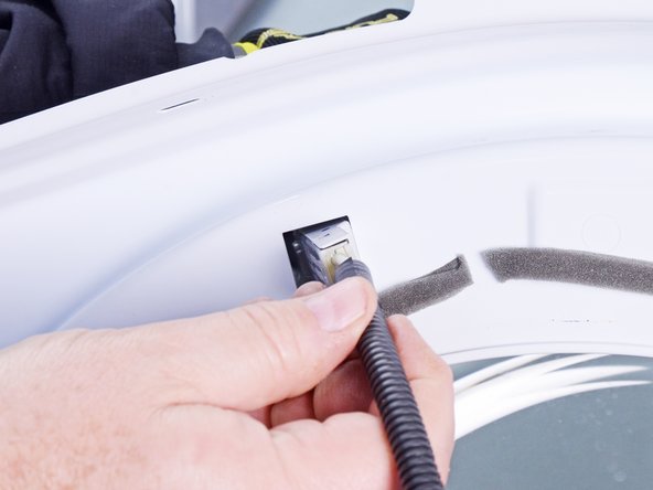

  15. Whirlpool Dryer Door Switch Testing and Replacement: 步骤 15 中的图像 1,2 Whirlpool Dryer Door Switch Testing and Replacement: 步骤 15 中的图像 2,2
    • Feed the harness through the mounting hole to remove the switch.
    • The second photo shows the switch removed so you can see the mounting flange. This flange is on the front of the switch and faces the dryer door.
