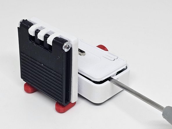

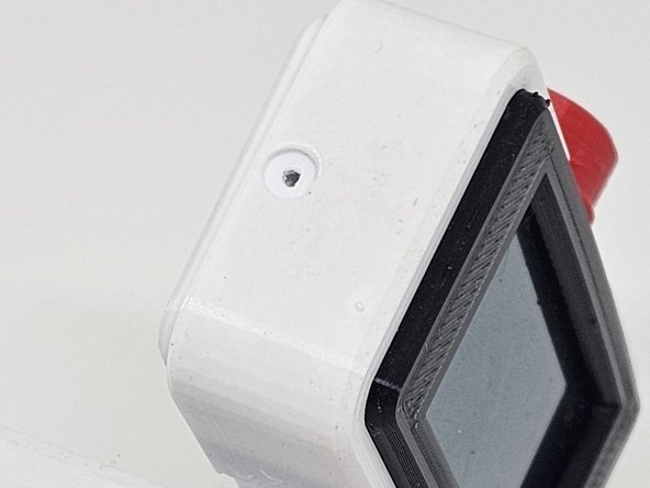

  1. WebScreen Teardown, Remove the Side Screw from the Enclosure: 步骤 1 中的图像 1,3 WebScreen Teardown, Remove the Side Screw from the Enclosure: 步骤 1 中的图像 2,3 WebScreen Teardown, Remove the Side Screw from the Enclosure: 步骤 1 中的图像 3,3
    • Description: The side screw secures the enclosure and must be removed first.
    • Action: Use a precision screwdriver to remove the M1.5 side screw.

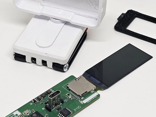

  6. WebScreen Teardown, Remove the PCB along with the Connected Display: 步骤 6 中的图像 1,3 WebScreen Teardown, Remove the PCB along with the Connected Display: 步骤 6 中的图像 2,3 WebScreen Teardown, Remove the PCB along with the Connected Display: 步骤 6 中的图像 3,3
    • Description: With the enclosure disassembled, the PCB along with the display can be removed as a single unit.
    • Action: ●​ Carefully hold the PCB and display, ensuring there are no forced connections. ●​ Slowly lift both components at the same time.

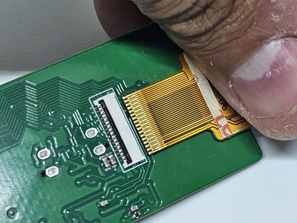

  7. WebScreen Teardown, Disconnect the Display: 步骤 7 中的图像 1,3 WebScreen Teardown, Disconnect the Display: 步骤 7 中的图像 2,3 WebScreen Teardown, Disconnect the Display: 步骤 7 中的图像 3,3
    • Description: With the PCB removed from the enclosure, the display can now be disconnected.​
    • Action: ●​ Use anti-static tweezers to gently disconnect the display’s flex cable. ●​ Ensure there are no active connections before fully removing it.
