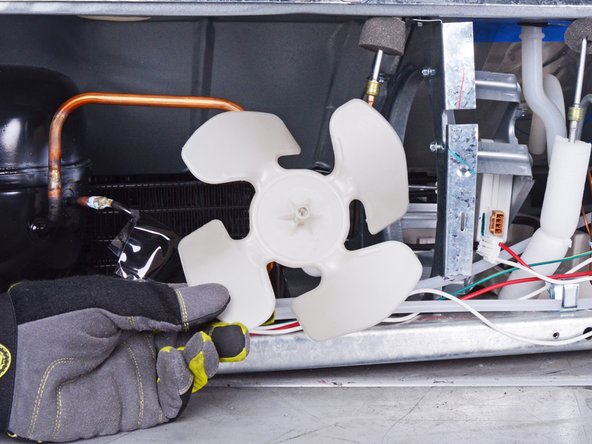

  10. WRS315SDHW Drain Pan Replacement, Remove the condenser fan: 步骤 10 中的图像 1,3 WRS315SDHW Drain Pan Replacement, Remove the condenser fan: 步骤 10 中的图像 2,3 WRS315SDHW Drain Pan Replacement, Remove the condenser fan: 步骤 10 中的图像 3,3
    • Put on gloves before continuing, as the sheet metal and the condenser fan itself are sharp.
    • Pull the condenser fan straight off its peg to remove it.

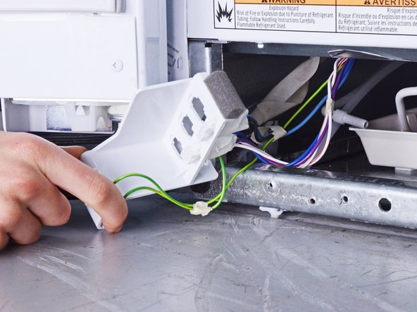

  12. WRS315SDHW Drain Pan Replacement, Reposition the wiring harness: 步骤 12 中的图像 1,3 WRS315SDHW Drain Pan Replacement, Reposition the wiring harness: 步骤 12 中的图像 2,3 WRS315SDHW Drain Pan Replacement, Reposition the wiring harness: 步骤 12 中的图像 3,3
    • Pull the wiring harness straight out of the chassis until you can access the drain pan.
