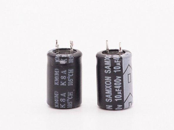

    • The components on the two boards are glued and fixed, and the top of the electrolytic capacitorhas an insulating sleeve and is insulated with high-temperature tape.

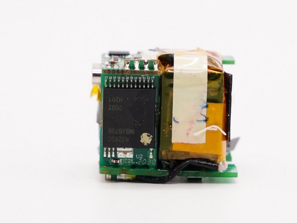

    • The main control chip power supply capacitor is from Aihua, the specification is 50V 10μF.

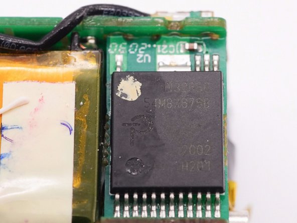

    • The main control chip of the charger is installed on the small board connecting the primary and secondary, and the transformer is placed on the right side.
    • The main control chip of the charger comes from PI, which is the same supplier as Apple's 18W PD fast charge. Model INN3265C, built-in primary PWM controller, switching tube and secondary synchronous rectification controller, high integration, support wide voltage input, 22W output power.

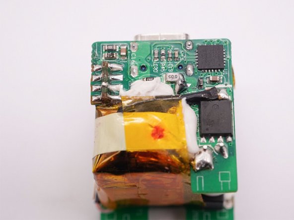

    • A synchronous rectification MOS tube and a protocol chip are provided on the back of the secondary board.
    • Remove the small board, and there are Y capacitors, solid capacitors and output VBUS switch tubes on the front
