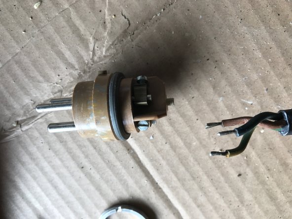

    • Using the long nose pliers remove the retaining ring by unscrewing it counter-clockwise from the inner assembly.
  5. TGL 57-1022 Disassembly: 步骤 5 中的图像 1,2 TGL 57-1022 Disassembly: 步骤 5 中的图像 2,2
    • Push the cable into the inner assembly until the connector is fully exposed from the assembly.
    • From the plug end, gently push the cable out to expose the two metal rings and rubber water-proofing ring.
  6. TGL 57-1022 Disassembly: 步骤 6 中的图像 1,2 TGL 57-1022 Disassembly: 步骤 6 中的图像 2,2
    • Using the screwdriver release the clip securing the cable to the plug housing.
    • Unscrew the leads from the plug terminals.
