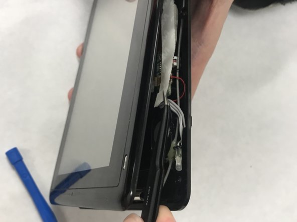

  8. Sungale Cyberus ID707WTA Screen Replacement: 步骤 8 中的图像 1,2 Sungale Cyberus ID707WTA Screen Replacement: 步骤 8 中的图像 2,2
    • Pry the screen open with the blue plastic opening tools while using another plastic opening tool as a jack to remain in place while you pry around the entire screen.
  9. Sungale Cyberus ID707WTA Screen Replacement: 步骤 9 中的图像 1,1
    • Lift the screen away from the case. Be careful, the screen shown lifted here is actually put together in multiple layers so you'll want to be careful not to separate them.
