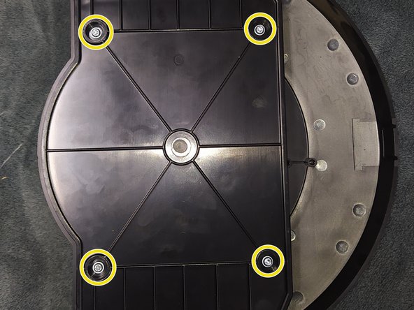

  1. SolarLog 300  Corrupt Firmware Fix, Open back panel: 步骤 1 中的图像 1,3 SolarLog 300  Corrupt Firmware Fix, Open back panel: 步骤 1 中的图像 2,3 SolarLog 300  Corrupt Firmware Fix, Open back panel: 步骤 1 中的图像 3,3
    • Remove all 4 screws with Torx T10 bit/driver (See Picture 2)
    • Then, remove the back panel to reveal the main PCB (See Picture 3)
