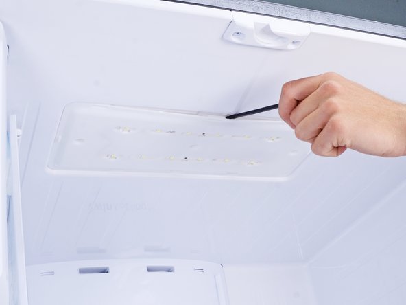

  3. Samsung Refrigerator Light (Refrigerator Compartment) Replacement, Remove the light cover: 步骤 3 中的图像 1,3 Samsung Refrigerator Light (Refrigerator Compartment) Replacement, Remove the light cover: 步骤 3 中的图像 2,3 Samsung Refrigerator Light (Refrigerator Compartment) Replacement, Remove the light cover: 步骤 3 中的图像 3,3
    • Plastic clips hold the light cover in place.
    • Use a spudger to pry along the back edge of the light cover.
    • You can also use a flathead screwdriver, but be careful not to let the screwdriver slip, or you'll scratch your refrigerator surface.
    • Remove the light cover.

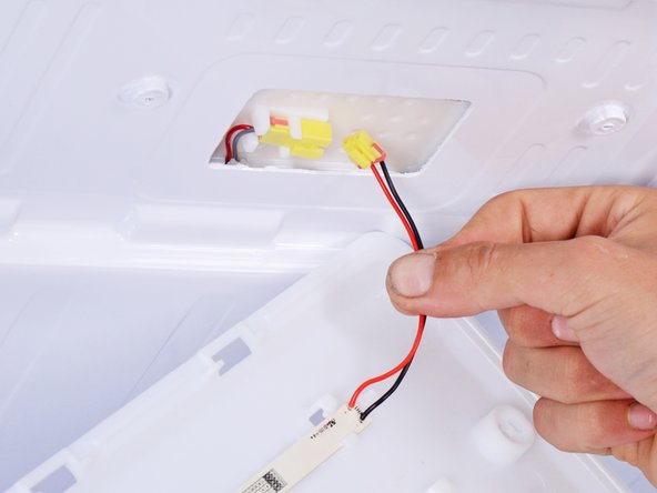

  6. Samsung Refrigerator Light (Refrigerator Compartment) Replacement: 步骤 6 中的图像 1,2 Samsung Refrigerator Light (Refrigerator Compartment) Replacement: 步骤 6 中的图像 2,2
    • Use your fingers to unplug the light's wire connector.
  7. Samsung Refrigerator Light (Refrigerator Compartment) Replacement: 步骤 7 中的图像 1,1
    • Remove the refrigerator light.
