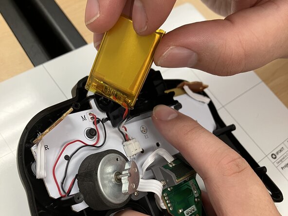

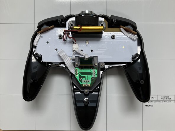

  6. SAFFUN Wireless N64 Controller Button Replacement: 步骤 6 中的图像 1,2 SAFFUN Wireless N64 Controller Button Replacement: 步骤 6 中的图像 2,2
    • Remove battery, rumble motor, and set aside.
    • Do not rip out the wires.

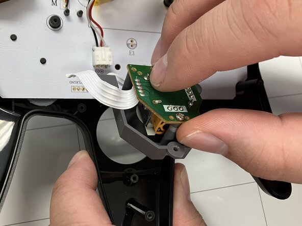

    • Remove joystick board.

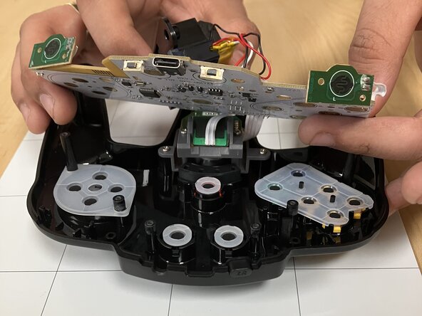

  10. SAFFUN Wireless N64 Controller Button Replacement: 步骤 10 中的图像 1,3 SAFFUN Wireless N64 Controller Button Replacement: 步骤 10 中的图像 2,3 SAFFUN Wireless N64 Controller Button Replacement: 步骤 10 中的图像 3,3
    • Place joystick onto motherboard.
    • Carefully lift the motherboard by its edges and remove it from the case.
    • Use a spudger to lift the board slightly, then remove it by hand.
  11. SAFFUN Wireless N64 Controller Button Replacement: 步骤 11 中的图像 1,1
    • Lift up and away from the controller.

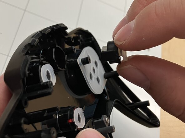

  15. SAFFUN Wireless N64 Controller Button Replacement: 步骤 15 中的图像 1,3 SAFFUN Wireless N64 Controller Button Replacement: 步骤 15 中的图像 2,3 SAFFUN Wireless N64 Controller Button Replacement: 步骤 15 中的图像 3,3

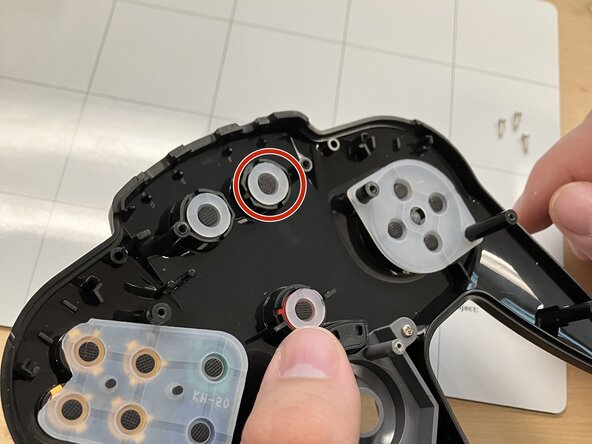

    • Pop out the start button with your finger on the outside of the frontplate.
    • Make sure the start button is placed back in the correct slot when replacing.

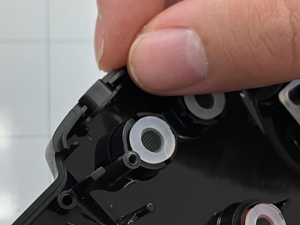

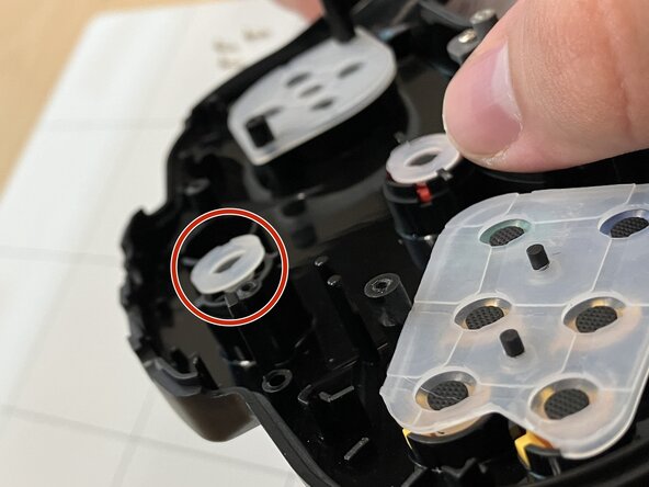

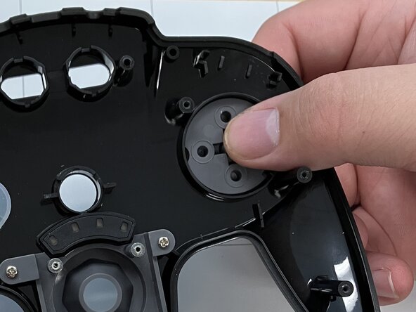

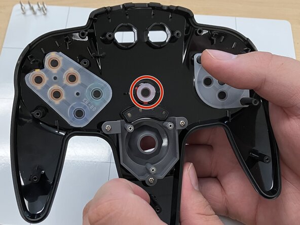

    • Remove rubber covering.
    • Pop out the D-Pad with your finger on the outside of the frontplate.
    • Make sure the D-Pad is placed back in the correct slot when replacing.

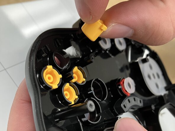

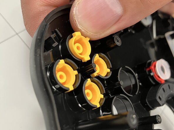

  17. SAFFUN Wireless N64 Controller Button Replacement: 步骤 17 中的图像 1,3 SAFFUN Wireless N64 Controller Button Replacement: 步骤 17 中的图像 2,3 SAFFUN Wireless N64 Controller Button Replacement: 步骤 17 中的图像 3,3
    • Pop out each yellow button with your finger on the outside of the frontplate.
    • Make sure each yellow button is placed back in the correct slot when replacing.

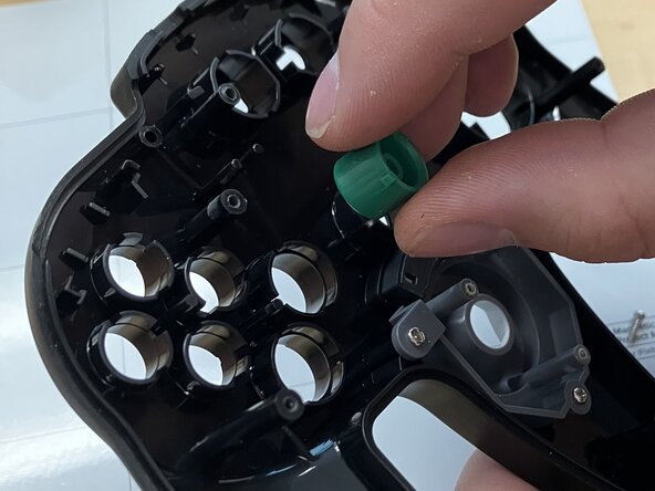

  18. SAFFUN Wireless N64 Controller Button Replacement: 步骤 18 中的图像 1,2 SAFFUN Wireless N64 Controller Button Replacement: 步骤 18 中的图像 2,2
    • Pop out blue and green buttons with your finger on the outside of the frontplate.
    • Make sure each button is placed back in the correct slot when replacing.
