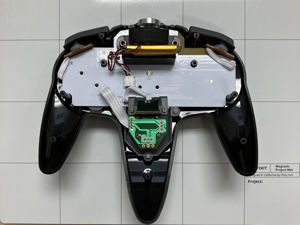

  7. SAFFUN Wireless N64 Controller Battery Replacement: 步骤 7 中的图像 1,1
    • Locate the power supply unit (PSU) on the motherboard shown by the red square.

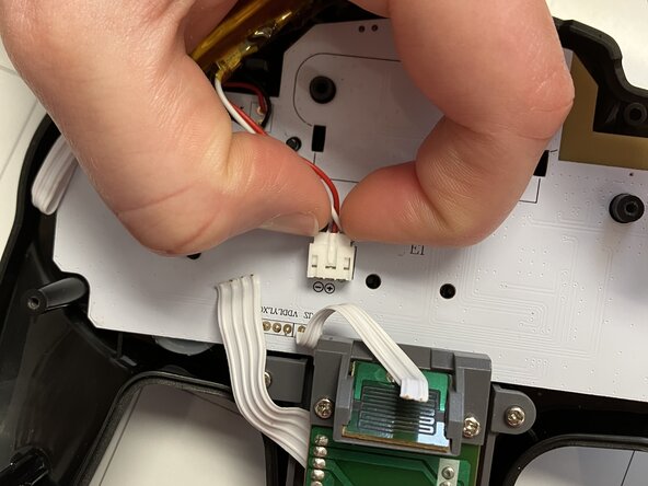

  8. SAFFUN Wireless N64 Controller Battery Replacement: 步骤 8 中的图像 1,3 SAFFUN Wireless N64 Controller Battery Replacement: 步骤 8 中的图像 2,3 SAFFUN Wireless N64 Controller Battery Replacement: 步骤 8 中的图像 3,3
    • Squeeze the side clips on the battery connector and pull the battery cable straight out of its socket on the board.
    • Do not pull on the wires, as this can damage the connector.
