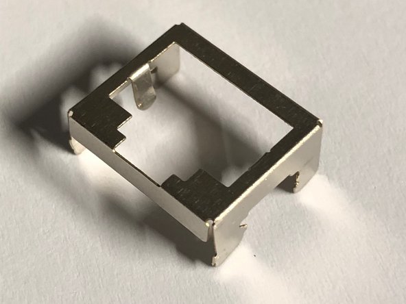

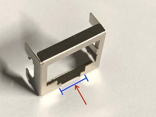

    • I purchased an "RJ45 Coupler" (Brand: Huakan) on Amazon. At the time of repair 6 couplers were sold for $6.99 ... now they are $9.99 (USA). These couplers have a thin stainless-steel frame on each side where the LAN cable "clicks" into the coupler.
1- Using a hacksaw blade, carefully cut lengthwise through the black ABS plastic covering. Use fine needle-nose pliers to peel-off the outer plastic layer. Use same pliers, to break/peel off the green rectangular circuit board.
  2. Repair Broken LAN Socket "Click Retainer" RJ45 socket: 步骤 2 中的图像 1,1
    • 2- Clip the little stainless steel "nubs" from the flat sides (2-sides to each coupler, 4 total) ... also clip the black plastic "nubs" from the sides of the stainless-steel face frames. Gently push off the stainless steel face frames from the body of the RJ45 socket (2 of them).

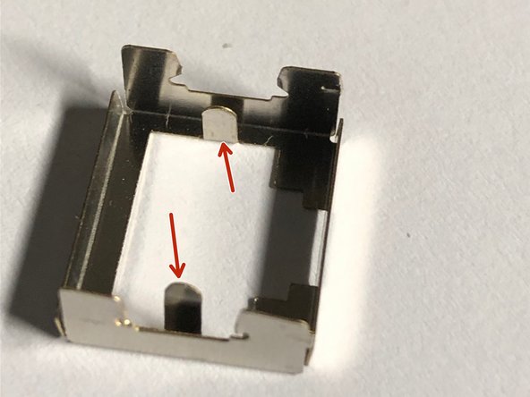

  3. Repair Broken LAN Socket "Click Retainer" RJ45 socket: 步骤 3 中的图像 1,3 Repair Broken LAN Socket "Click Retainer" RJ45 socket: 步骤 3 中的图像 2,3 Repair Broken LAN Socket "Click Retainer" RJ45 socket: 步骤 3 中的图像 3,3
    • After separating the stainless-steel face-frames from the RJ45 Coupler, then note the red-arrow designated "prongs" that may be adjusted to give the best "fit" over the broken RJ45 socket. Adjust as needed to provide a deep-seated firm fit.
    • Clean stainless-steel frames with isopropyl (rubbing) alcohol, also swab the edge of the broken RJ45 socket. The new frame will cover green & amber LED lights, the lights are still partly visible when lighted or when flashing.
