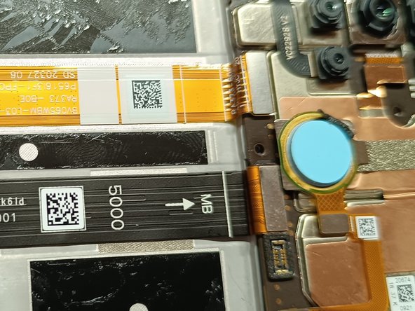

    • Remove the sim card tray and pry the side of the frame,they are held on with tiny clips.
  5. Realme 7i Screen Replacement, Disconnect and remove the battery: 步骤 5 中的图像 1,3 Realme 7i Screen Replacement, Disconnect and remove the battery: 步骤 5 中的图像 2,3 Realme 7i Screen Replacement, Disconnect and remove the battery: 步骤 5 中的图像 3,3
    • Disconnect the battery from the motherboard and peel off the plastics on both sides of the battery. Pull on the green tab firmly and gently until the battery is free.
  6. Realme 7i Screen Replacement, Removing the screen: 步骤 6 中的图像 1,3 Realme 7i Screen Replacement, Removing the screen: 步骤 6 中的图像 2,3 Realme 7i Screen Replacement, Removing the screen: 步骤 6 中的图像 3,3
    • Remove the adhesive plastic and disconnect the screen from the motherboard. The screen can then be pried off from the front.
