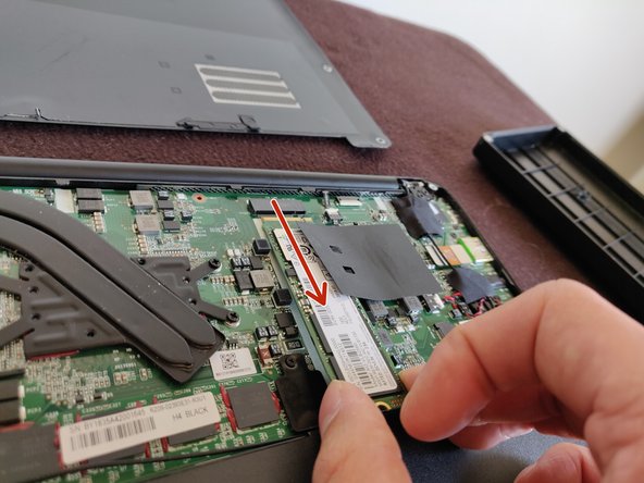

  5. Razer Blade Stealth 2017 SSD Replacement: 步骤 5 中的图像 1,1
    • Gently pull the SSD towards you to remove it
