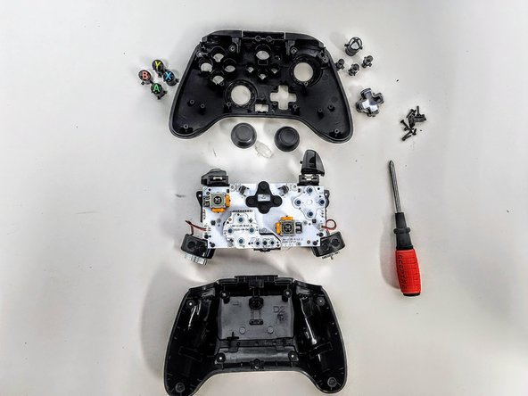

  1. PowerA Enhanced 1516953-01 Front Case Replacement, Rear Case: 步骤 1 中的图像 1,3 PowerA Enhanced 1516953-01 Front Case Replacement, Rear Case: 步骤 1 中的图像 2,3 PowerA Enhanced 1516953-01 Front Case Replacement, Rear Case: 步骤 1 中的图像 3,3
    • Lay the controller face down.
    • Use a Phillips screwdriver to remove the eight 9.2 mm screws that secure the rear case.
    • Lift the rear case up and off of the chassis.
  2. PowerA Enhanced 1516953-01 Front Case Replacement, Motherboard: 步骤 2 中的图像 1,3 PowerA Enhanced 1516953-01 Front Case Replacement, Motherboard: 步骤 2 中的图像 2,3 PowerA Enhanced 1516953-01 Front Case Replacement, Motherboard: 步骤 2 中的图像 3,3
    • Remove the two 3.3 mm Phillips screws that secure the motherboard to the front case.
    • Lift the motherboard up and out of the chassis.

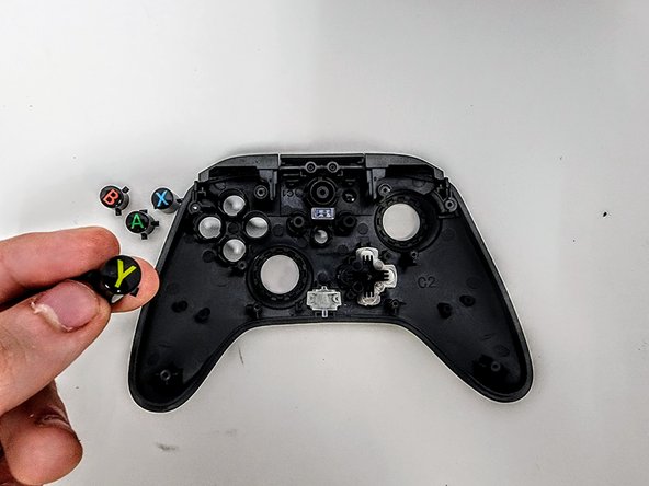

  3. PowerA Enhanced 1516953-01 Front Case Replacement, ABXY Buttons: 步骤 3 中的图像 1,3 PowerA Enhanced 1516953-01 Front Case Replacement, ABXY Buttons: 步骤 3 中的图像 2,3 PowerA Enhanced 1516953-01 Front Case Replacement, ABXY Buttons: 步骤 3 中的图像 3,3
    • Grip and remove each button.

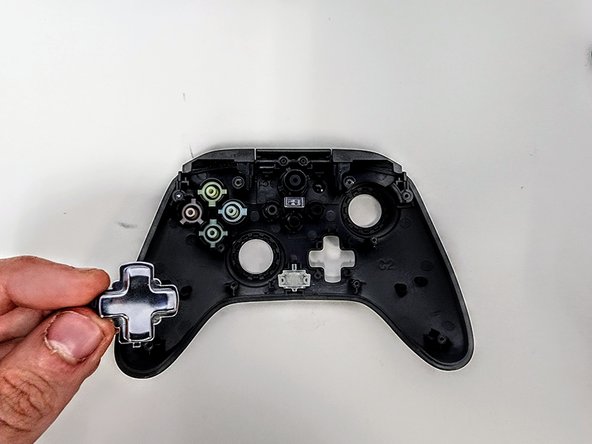

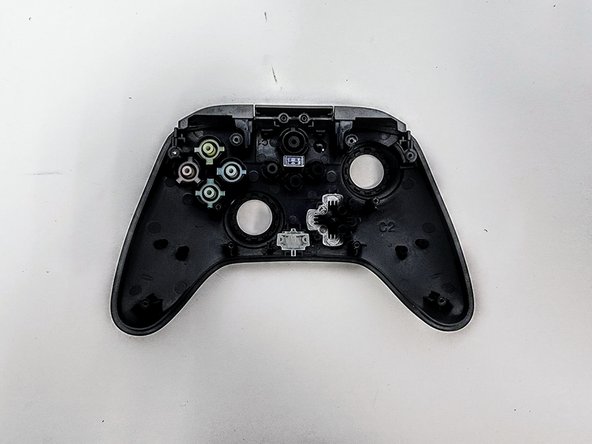

  4. PowerA Enhanced 1516953-01 Front Case Replacement, Front Case: 步骤 4 中的图像 1,3 PowerA Enhanced 1516953-01 Front Case Replacement, Front Case: 步骤 4 中的图像 2,3 PowerA Enhanced 1516953-01 Front Case Replacement, Front Case: 步骤 4 中的图像 3,3
    • Lift the bumper assembly up and out of its housing.
    • Lift the D-pad up and out of its housing.
    • Remove the ABXY buttons.
  5. PowerA Enhanced 1516953-01 Front Case Replacement: 步骤 5 中的图像 1,2 PowerA Enhanced 1516953-01 Front Case Replacement: 步骤 5 中的图像 2,2
    • The additional advanced buttons can be poured out from the faceplate.
