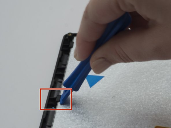

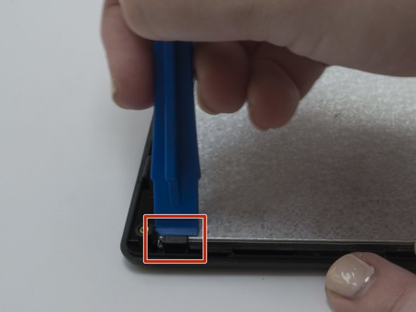

  6. Polaroid PMID701i 10 Screen Replacement, Screen: 步骤 6 中的图像 1,3 Polaroid PMID701i 10 Screen Replacement, Screen: 步骤 6 中的图像 2,3 Polaroid PMID701i 10 Screen Replacement, Screen: 步骤 6 中的图像 3,3
    • Set the top panel down so that the interior faces up, and the exterior of the screen faces down.
    • The screen attaches to to the panel with six black plastic snaps.
    • Using the Opening Tool, gently lift up each of the snaps to release the screen from the panel.
    • If a snap does not release when using the tool, attempt to lift it by hand.
  7. Polaroid PMID701i 10 Screen Replacement: 步骤 7 中的图像 1,1
    • Remove the screen from the frame by lifting it from the side.

In terms of removing the screen, we found the plastic opening tool didn't help to lift the snaps to release the screen from the panel. It worked better when we used our hands to snap it out.
Megan Rule - 回复
