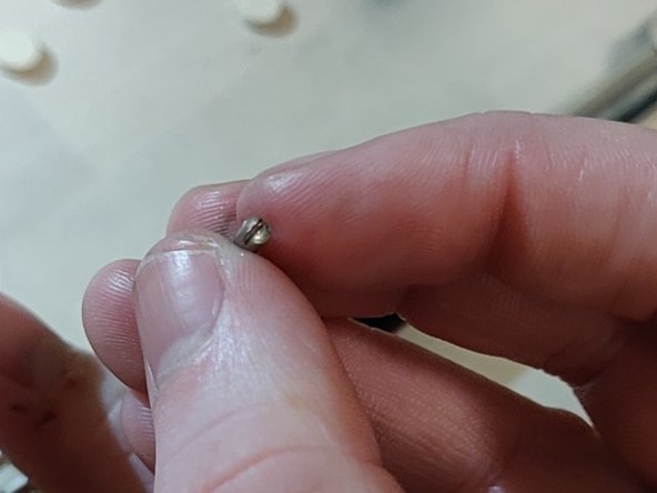

    • Use the 2.0 mm screwdriver to unscrew the top rod of the piccolo.
    • Once the screw is sufficiently removed, it can be completely pulled out with your fingers or with pliers.
    • If pliers are used, be sure to clamp at the two ends of the indention. This ensures the indention is not accidentally clamped shut.
    • After the screw has been removed from the rod entirely, pull the B key off of the piccolo. There should be no resistance.

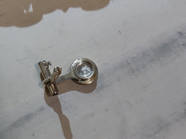

    • Use the denatured alcohol lamp or torch lighter on the top of the key (opposite side of the pad) to melt the glue.
    • The denatured alcohol lamp is used to ensure no residue is left on the top of the key. If the torch lighter is used, residue may be left over, changing the appearance of the key.
    • Remove the old pad from the key.
    • Scrape out any remaining glue with the 2.0 mm screwdriver.
