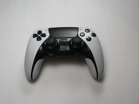

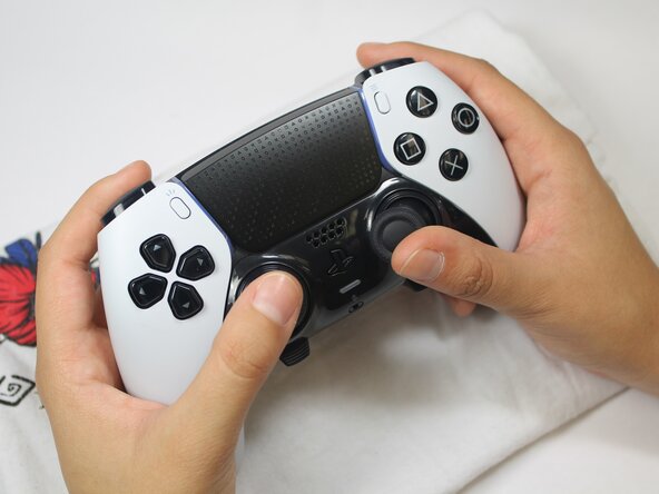

    • Make sure your controller is turned off and unplugged from any cables or devices.
    • Working on a powered controller can cause damage or short circuits. Always make sure to power it down first!
    • Have your supplies ready: your controller, stick module unit, and a soft surface to prevent any damage while following these steps.

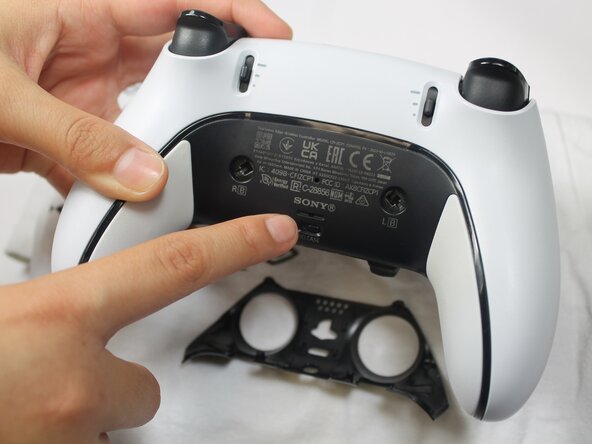

  2. PS5 DualSense Edge Controller Stick Module Replacement: 步骤 2 中的图像 1,2 PS5 DualSense Edge Controller Stick Module Replacement: 步骤 2 中的图像 2,2
    • Turn the controller over so the back is facing you.
    • Near the bottom, find the small switch labeled "Release" and slide it.
    • The front plate should come off.
    • Do not pry or bend the faceplate; it is designed to come off easily with the release switch.

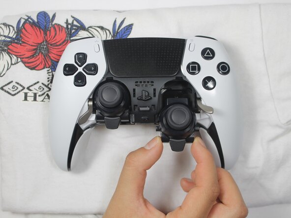

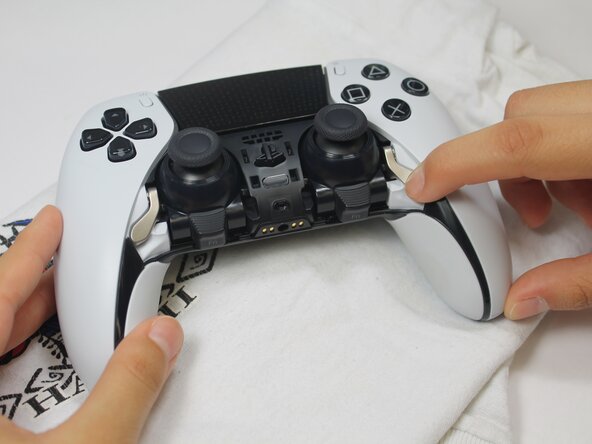

  3. PS5 DualSense Edge Controller Stick Module Replacement: 步骤 3 中的图像 1,2 PS5 DualSense Edge Controller Stick Module Replacement: 步骤 3 中的图像 2,2
    • Identify the analog stick module you'll want to replace.
    • Each module is secured with a silver latch tab.
    • Gently pull up on the wide part of the latch tab until you hear two clicks.
  4. PS5 DualSense Edge Controller Stick Module Replacement: 步骤 4 中的图像 1,2 PS5 DualSense Edge Controller Stick Module Replacement: 步骤 4 中的图像 2,2
    • Release and remove the module.
    • The module will slide forward, indicating the disconnection from the controller, and is ready to be removed.
    • Carefully pull it out.

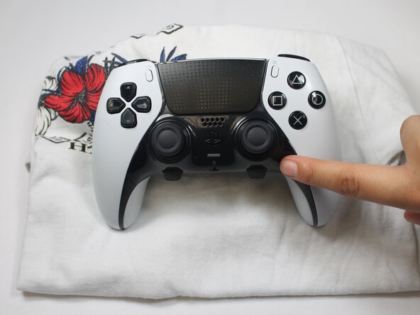

  6. PS5 DualSense Edge Controller Stick Module Replacement: 步骤 6 中的图像 1,3 PS5 DualSense Edge Controller Stick Module Replacement: 步骤 6 中的图像 2,3 PS5 DualSense Edge Controller Stick Module Replacement: 步骤 6 中的图像 3,3
    • Line up the faceplate with the front of the controller.
    • Ensure that the top clips of the faceplate are aligned with the holes above the stick modules before snapping it in place
    • Press it back on until it snaps firmly into place.
