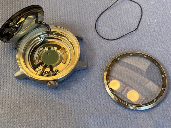

  1. Opening the Withings ScanWatch (Gen 1), Separate the Watch Face From the Case: 步骤 1 中的图像 1,1
    • The watch is held together by friction and a thin black seal—there are no screws.
    • Insert a thin metal smartphone opener between the metal case and the glass/display side of the watch (not the sensor side).
    • Carefully work your way around to loosen the seal.
    • The opening direction is often misunderstood—it’s from the face side, not the back sensor.
  2. Opening the Withings ScanWatch (Gen 1), Disconnect the Sensor Cable: 步骤 2 中的图像 1,1
    • Once the watch is open, you’ll see the movement and a small cable connecting the sensor to it.
    • This cable uses a connector similar to iPhones and can be released with a plastic spudger.
    • Gently pry the connector straight up to avoid damage.
    • Do not yank the cable. Always release the connector first.
  3. Opening the Withings ScanWatch (Gen 1), Inspect the Sensor Window (if Water Damage Suspected): 步骤 3 中的图像 1,1
    • In this case, the condensation came from the glass above the sensor.
    • From the inside, this glass popped out easily—suggesting poor or insufficient glue.
    • Clean the glass and sensor area thoroughly with isopropyl alcohol.
    • Re-glue the glass using a thin layer of T-8000 adhesive.
    • Don’t apply too much glue—it can squeeze onto the sensor surface.
    • If your crown is stuck or hard to press, it may be repairable from the inside.
    • Add a small drop of penetrating oil (e.g. WD-40 or watchmaker’s oil) to the base of the crown from the inside.
    • This is optional and should be done with care.
    • The battery can be replaced, but it's soldered to the board.
    • Requires soldering skills and proper tools.
    • This is not a beginner repair step and may damage the board.
    • Reconnect the sensor cable.
    • Make sure the o-ring seal sits completely in the corner of the metal ring
    • Snap the glass and ring back in with even pressure. This may require some force.
    • Clean any adhesive residue and allow glue to cure if used.
    • If the seal isn't seated properly, the watch won't fully close.
