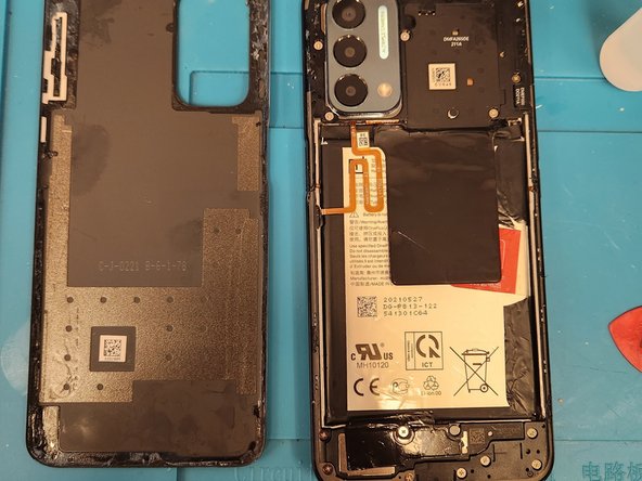

  1. OnePlus Nord N200 Sub Board Replacement, Sub/Charger Board: 步骤 1 中的图像 1,3 OnePlus Nord N200 Sub Board Replacement, Sub/Charger Board: 步骤 1 中的图像 2,3 OnePlus Nord N200 Sub Board Replacement, Sub/Charger Board: 步骤 1 中的图像 3,3
    • Take sim tray out prior to beginning repair.
    • Heat back of phone to make the adhesion more pliable
    • Insert a slim prying tool to begin removing the back cover, move in a counterclockwise direction
    • Add IPA as you work to detatch the adhesion layer
    • When approaching the volume button, be cautious, as the ribbon cable is exposed and can easilyt be cut
    • Remove back cover

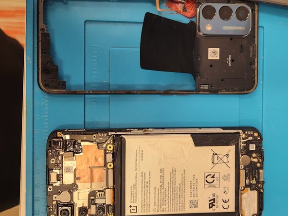

  2. OnePlus Nord N200 Sub Board Replacement: 步骤 2 中的图像 1,3 OnePlus Nord N200 Sub Board Replacement: 步骤 2 中的图像 2,3 OnePlus Nord N200 Sub Board Replacement: 步骤 2 中的图像 3,3
    • Using a J000 screwdriver, remove the Screws holding the edge casing to the screen (19 Total)
    • Using a pry tool, seperate the edge plastic from the screen
    • Once you have attained suitable lift, disconnect the power button cable.
    • Remove the edge plastic and set aside.
