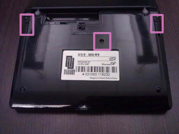

  2. Nurian R9 Screen Replacement: 步骤 2 中的图像 1,1
    • Remove 3 black screws from back of device with the screwdriver. Set screws aside in a jewelry rack or other safe place.

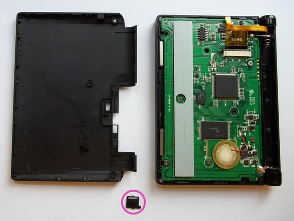

  3. Nurian R9 Screen Replacement: 步骤 3 中的图像 1,2 Nurian R9 Screen Replacement: 步骤 3 中的图像 2,2
    • Use spudger (black tool) to remove black plastic back of the device. Take care when removing the back of the device. The plastic tabs under the back are fragile and may break while prying with the spudger.
    • Take care not lose the lock/unlock switch as it is freed from the back of the device. (This is the same switch you used to open the battery door in step 1; it's marked in pink in the second photo).

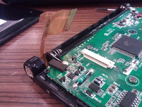

  4. Nurian R9 Screen Replacement: 步骤 4 中的图像 1,2 Nurian R9 Screen Replacement: 步骤 4 中的图像 2,2
    • Carefully remove the ribbon from motherboard. Grip the ribbon clip carefully by prying from each side. Set clip (marked with pink) aside in a safe place.

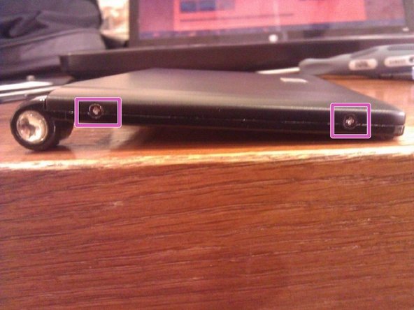

  6. Nurian R9 Screen Replacement: 步骤 6 中的图像 1,1
    • Remove the 4 silver screws from the sides of the screen with the screwdriver. There are two screws on each side. Set screws aside.

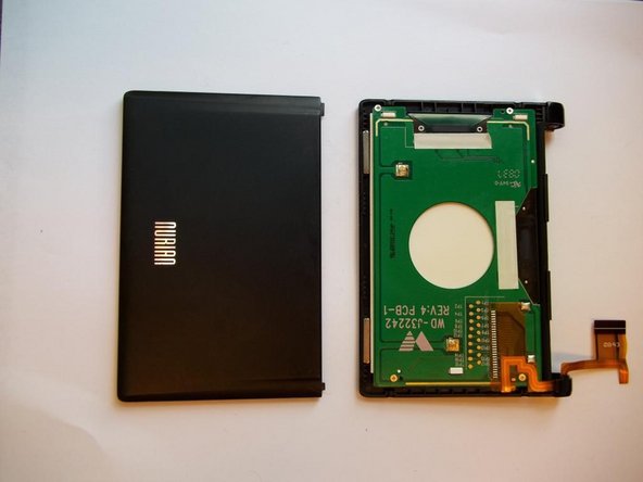

  7. Nurian R9 Screen Replacement: 步骤 7 中的图像 1,2 Nurian R9 Screen Replacement: 步骤 7 中的图像 2,2
    • Remove the plastic cover from the back of the screen using the plastic opening tool. Again, use caution.
    • It is easier to separate the cover if you start prying from the corner opposite the hinge.

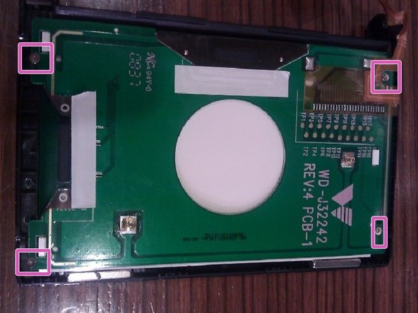

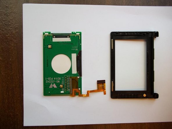

  8. Nurian R9 Screen Replacement: 步骤 8 中的图像 1,3 Nurian R9 Screen Replacement: 步骤 8 中的图像 2,3 Nurian R9 Screen Replacement: 步骤 8 中的图像 3,3
    • Remove the 4 silver screws from the circuit board using the screwdriver. Set screws aside.
    • Remove screen and circuit board from the black frame with your hand; it should come easily.

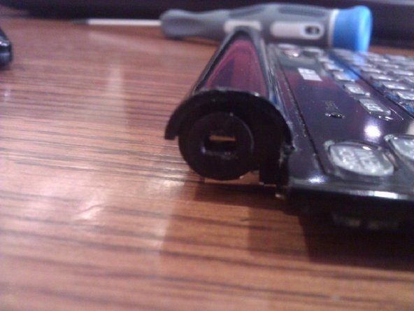

  11. Nurian R9 Screen Replacement: 步骤 11 中的图像 1,3 Nurian R9 Screen Replacement: 步骤 11 中的图像 2,3 Nurian R9 Screen Replacement: 步骤 11 中的图像 3,3
    • Reattach the two halves along the hinge by sliding the screen half's silver tooth (shown in the first photo) into the keyboard half's rectangular slot (shown in the second photo).
    • Be sure that ribbon realigns with the motherboard (as shown in the third photo).
