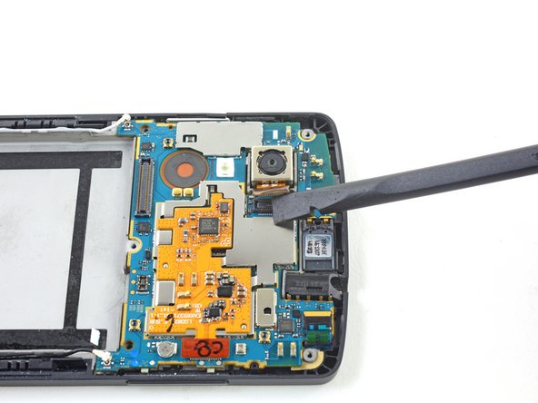

  5. Nexus 5 Rear Facing Camera Replacement, Rear Facing Camera: 步骤 5 中的图像 1,2 Nexus 5 Rear Facing Camera Replacement, Rear Facing Camera: 步骤 5 中的图像 2,2
    • Use the flat end of a spudger to disconnect the rear-facing camera.
    • Although the battery is not pictured in this step, it is not necessary to fully remove it in order to get to the rear-facing camera (Only disconnecting it is necessary).
