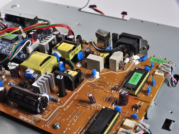

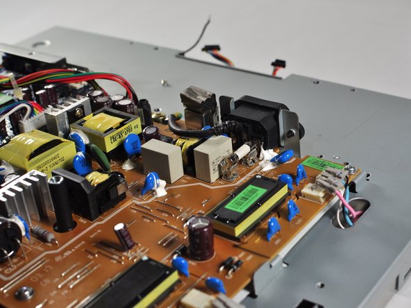

  14. NEC LCD1770NX Fuse Replacement, Fuse: 步骤 14 中的图像 1,2 NEC LCD1770NX Fuse Replacement, Fuse: 步骤 14 中的图像 2,2
    • Carefully insert the prying tool underneath the power supply fuse.
    • Using the prying tool, lift the power supply fuse out of its emplacement until it is resting on its clamps.
  15. NEC LCD1770NX Fuse Replacement: 步骤 15 中的图像 1,1
    • Carefully remove the power supply fuse by hand.
  16. NEC LCD1770NX Fuse Replacement: 步骤 16 中的图像 1,3 NEC LCD1770NX Fuse Replacement: 步骤 16 中的图像 2,3 NEC LCD1770NX Fuse Replacement: 步骤 16 中的图像 3,3
    • Place the replacement power supply fuse on the fuse clips.
    • With a finger, press down on the ends of the replacement fuse until it is properly seated in the fuse clips.
