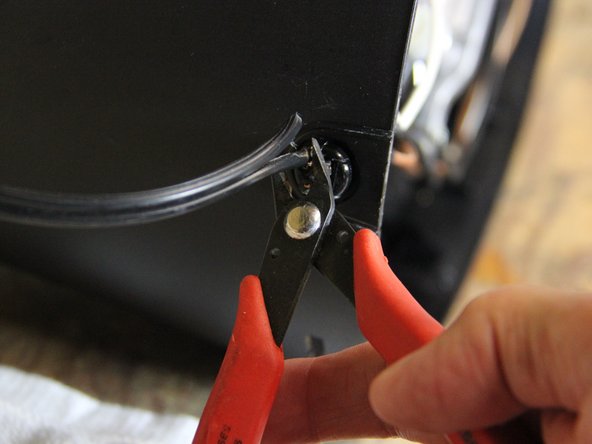

  2. Mr. Coffee power cord replacement for Model BVMC SC12BL1, Remove the old cord: 步骤 2 中的图像 1,2 Mr. Coffee power cord replacement for Model BVMC SC12BL1, Remove the old cord: 步骤 2 中的图像 2,2
    • Cut the cord off the outside of the unit near the cord strain relief. This cut cord will be used as the replacement power cord.
    • The power cord attaches to high temperature wires inside the unit. Cut where the high temperature wires connect to the power cord.

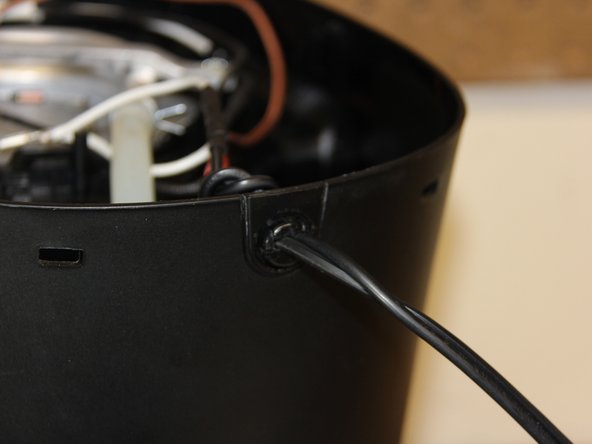

  4. Mr. Coffee power cord replacement for Model BVMC SC12BL1, Reattaching the power cord: 步骤 4 中的图像 1,3 Mr. Coffee power cord replacement for Model BVMC SC12BL1, Reattaching the power cord: 步骤 4 中的图像 2,3 Mr. Coffee power cord replacement for Model BVMC SC12BL1, Reattaching the power cord: 步骤 4 中的图像 3,3
    • Place the recovered cord through the strain relief making sure that the internal cord length will be long enough to attach to the high temperature wires.
    • Attach crimp connectors to the high temperature wires.
    • If the connectors do not heat shrink, be sure to slip heat shrink tubing onto the high temperature wires before connecting to the electric cord.
    • Crimp the connectors to the power cord.

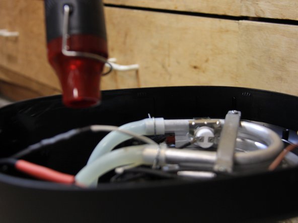

  5. Mr. Coffee power cord replacement for Model BVMC SC12BL1, Complete the project: 步骤 5 中的图像 1,2 Mr. Coffee power cord replacement for Model BVMC SC12BL1, Complete the project: 步骤 5 中的图像 2,2
    • Use a heat gun to shrink the heat shrink tubing around the crimped connectors.
    • Snap the bottom plate back on the unit and reattach the screw.
