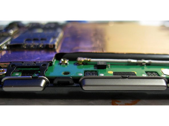

  6. Motorola G2 (G second Generation) Ear piece speaker Replacement, Reassemble and Test.: 步骤 6 中的图像 1,1
    • Your finished! Reassemble, note the side buttons fit in the case as show.
