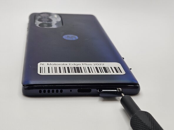

  2. Motorola Edge Plus 2022 Display Assembly Replacement: 步骤 2 中的图像 1,1
    • Insert a paperclip or SIM card ejector into the small hole located at the bottom of phone.
    • Gently push to release and remove the SIM card.

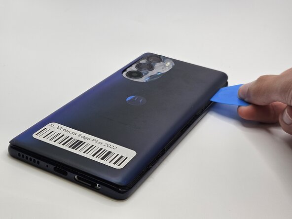

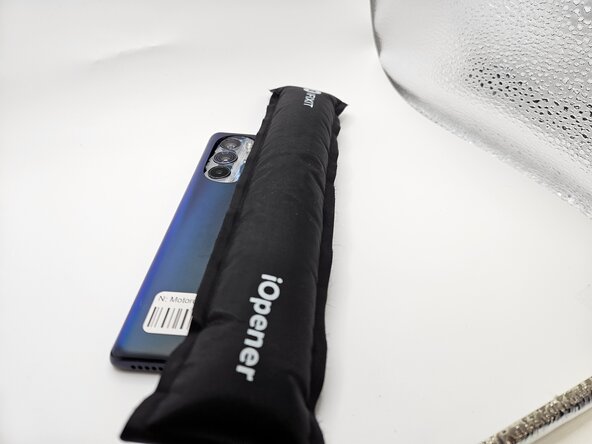

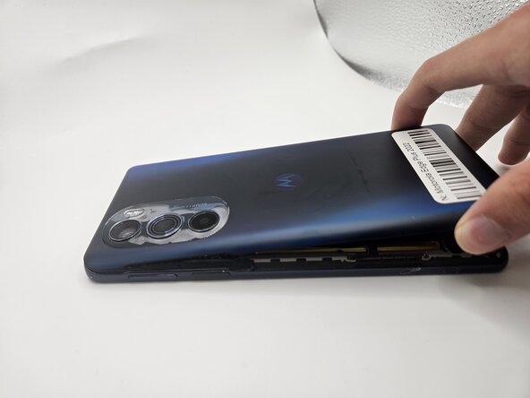

  3. Motorola Edge Plus 2022 Display Assembly Replacement: 步骤 3 中的图像 1,3 Motorola Edge Plus 2022 Display Assembly Replacement: 步骤 3 中的图像 2,3 Motorola Edge Plus 2022 Display Assembly Replacement: 步骤 3 中的图像 3,3
    • Use an iOpener, heat gun, or hairdryer to gently heat the perimeter of the phone.
    • Insert and slide the iFixit opening pick around heated edges to sever the adhesive securing the rear cover.

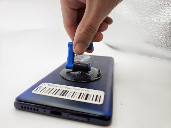

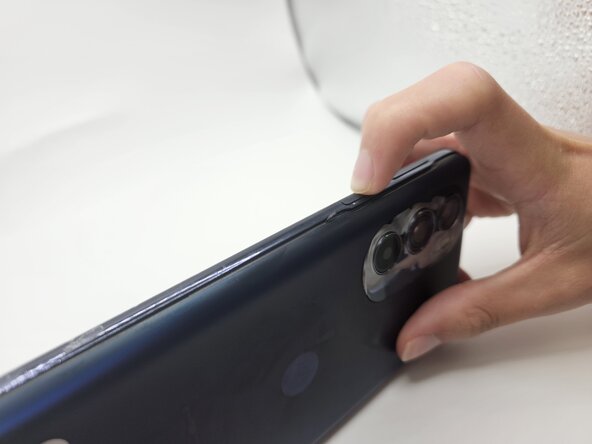

  4. Motorola Edge Plus 2022 Display Assembly Replacement: 步骤 4 中的图像 1,3 Motorola Edge Plus 2022 Display Assembly Replacement: 步骤 4 中的图像 2,3 Motorola Edge Plus 2022 Display Assembly Replacement: 步骤 4 中的图像 3,3
    • Gently remove the back cover using the suction handle or your bare hands.

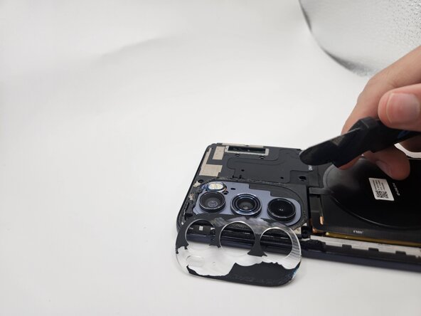

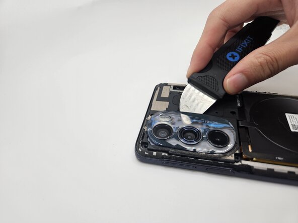

  5. Motorola Edge Plus 2022 Display Assembly Replacement: 步骤 5 中的图像 1,2 Motorola Edge Plus 2022 Display Assembly Replacement: 步骤 5 中的图像 2,2
    • While applying light pressure, remove the camera bezel cover by sliding the jimmy along the edges.

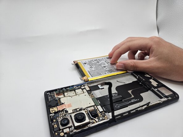

  9. Motorola Edge Plus 2022 Display Assembly Replacement: 步骤 9 中的图像 1,3 Motorola Edge Plus 2022 Display Assembly Replacement: 步骤 9 中的图像 2,3 Motorola Edge Plus 2022 Display Assembly Replacement: 步骤 9 中的图像 3,3
    • Gently lift the battery up using the black spudger and remove.
    • Applying too much force when removing the battery may damage it. Take care not to bend, warp, or puncture the battery.
    • Apply a few drops of isopropyl alcohol if the battery is tightly adhered.

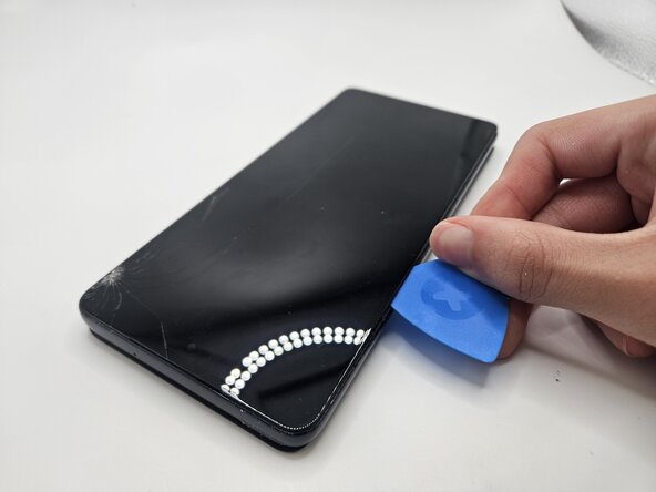

  10. Motorola Edge Plus 2022 Display Assembly Replacement, Display Assembly: 步骤 10 中的图像 1,3 Motorola Edge Plus 2022 Display Assembly Replacement, Display Assembly: 步骤 10 中的图像 2,3 Motorola Edge Plus 2022 Display Assembly Replacement, Display Assembly: 步骤 10 中的图像 3,3
    • Use an iOpener or heat gun to heat the perimeter of the phone.
    • Only apply heat for 30-45 seconds. Using the iOpener for longer may damage the insides of the phone.
    • Insert an opening pick 3 mm into the seam between the display and chassis.
    • Slide the opening pick around the heated edges to sever the adhesive securing the display.
