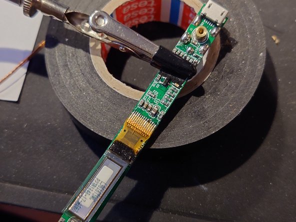

  2. Miniware TS100 Soldering Iron Display Replacement, Display detaching: 步骤 2 中的图像 1,1
    • Put tweezer tips between display module and two-sided adhesive sponge cushion between display and circuit board at free display end. Keep sponge in place and very carefully wiggle the display module upwards. It should come off the sponge with sponge remaining intact. Do the same with second sponge at flat cable side.
    • Warming up the sponge for 10 seconds with hot air from heat gun or hair dryer will help to free display from sponge much easier.
    • If you don't have spare EVA sponge, you can carefully remove the sponge cushion at display cable side and stick it nearby for later use. Sponge removal from circuit board is the same as removing from the display module.
    • Put the flux over flat display cable contact soldering line. I marked it with green arrow at second photo. Turn the soldering iron to 300C (570F) degrees. Heat the soldering line from one side and with tweezers carefully pull the loosened cable away from circuit board.
    • Be extremely careful on cable removing at top side in photo. There are two dead end tracks with pads that can easy lift up or get torn off and go away with display cable. Try to avoid that.
    • Work will be easier when circuit board is held in some soldering helping hand tool with soft coating around grips or in little vice. Be careful though and don't destroy any components on circuit board.
    • Flat cable desoldering is easier with shovel type T12-1402 tip or other similar flat wide tip. This will melt the solder in all cable width at once. Thus make removal process shorter and stress the circuit board less.
    • If you have difficulties with melting the solder: 1) use more flux. 2) turn soldering iron temperature 10-20 degrees warmer - many soldering irons show larger temperature number than tip actually have. 3) Use even more flux - do not skimp on it.
    • After cable removing clear solder remains from pads with desoldering braid. Clear the board around pads with cotton bud, soaked in PCB cleaner or isopropyl alcohol.
    • If during cable removal one or both dead-end pads lifted or got torn off, it is not complete failure yet. You have two options:
    • If pad is lifted, carefully arrange it in old position - different color area (yellowish, not green) under the pad. Put a dab of solder paste over it. Then carefully put desoldering braid above it, warm the spot for few seconds and let it cool off. Soldering paste will glue the pad back in the place. Clean the area afterwards.
    • If pad is completely torn off, inspect the area directly behind it where track from pad went further to small black resistor side. With scalpel carefully scrape off the green lacquer in 1mm length to reveal track copper. Put flux over it and tin the cleared track area. Clean the area afterwards.
  3. Miniware TS100 Soldering Iron Display Replacement, Soldering the display module: 步骤 5 中的图像 1,3 Miniware TS100 Soldering Iron Display Replacement, Soldering the display module: 步骤 5 中的图像 2,3 Miniware TS100 Soldering Iron Display Replacement, Soldering the display module: 步骤 5 中的图像 3,3
    • Put a line of flux paste over pads and flat cable end.
    • Take the display module with face side down. Put the flat cable on cleaned pads on circuit board. Arrange the cable over pads to left free pad area a little less than 1mm from the left side (in second photo).
    • Set soldering iron temperature to 270C (520F). Tin the soldering iron and solder the cable to the board.
    • Be careful. During soldering keep the cable pins directly above related board pads. Try to avoid board overheat though very long heating.
    • Solder the first and last cable pin before soldering the rest, That will keep the cable in place during soldering the remaining pins.
    • Cable soldering is easier with thin oval T12-BC2 tip or other similar tip. Otherwise you will need to use a lot of flux paste to avoid solder clumping in large area with pad shorting in result due to thick tip that help solder spread where it is not desired.
    • Inspect the cable soldering. If some pads and cable pins are shorted with solder bridges, put flux paste around the spot and remove excess solder with clean soldering iron tip. If necessary - with a help of desoldering braid.
    • Clear the board around pads with cotton bud, soaked in PCB cleaner or isopropyl alcohol.
