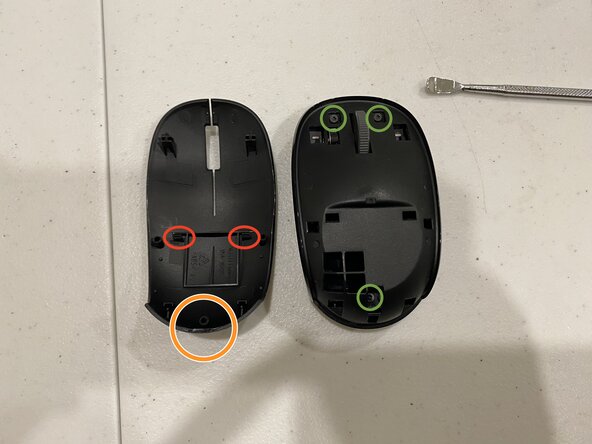

  3. Microsoft Wireless Mouse RJN-00001 disassembly: 步骤 3 中的图像 1,3 Microsoft Wireless Mouse RJN-00001 disassembly: 步骤 3 中的图像 2,3 Microsoft Wireless Mouse RJN-00001 disassembly: 步骤 3 中的图像 3,3
    • In the image, you can see two clips on the top cover (marked with red circles). Use a spudger to release them, then lift the top cover. There is also a hidden clip at the rear that can be easily disengaged. (marked with orange circles)
    • After that, remove the three T5 screws (marked with green circles) to lift off the mid-frame.
