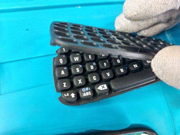

  3. Macs wireless keyboard for PS4 controller Disassembly: 步骤 3 中的图像 1,2 Macs wireless keyboard for PS4 controller Disassembly: 步骤 3 中的图像 2,2
    • Carefully remove the button caps.

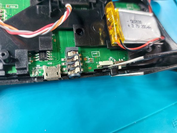

  4. Macs wireless keyboard for PS4 controller Disassembly: 步骤 4 中的图像 1,1
    • Move the battery out of the way.
    • The battery has been secured with adhesive tape, so slight force may have to be used.
    • Be careful not to pull too much on the battery, as the batterys cables are soldered on the board, and the solder may come off if pulled too much.
  5. Macs wireless keyboard for PS4 controller Disassembly: 步骤 5 中的图像 1,1
    • Move the 3,5 mm jack connector out of the way.
    • Use the same caution as for the battery cables. The jack cables are soldered on the board the same way as the battery cables are.

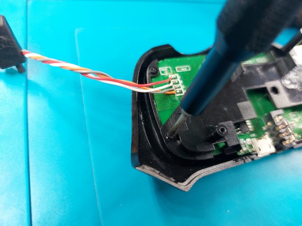

  6. Macs wireless keyboard for PS4 controller Disassembly: 步骤 6 中的图像 1,2 Macs wireless keyboard for PS4 controller Disassembly: 步骤 6 中的图像 2,2
    • Unscrew the last four 5 mm screws from the frame, with a Phillips #000 size bit.

  8. Macs wireless keyboard for PS4 controller Disassembly: 步骤 8 中的图像 1,2 Macs wireless keyboard for PS4 controller Disassembly: 步骤 8 中的图像 2,2
    • The keyboard buttons come off just by lifting.
