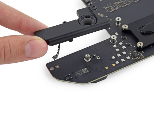

  26. Mac mini Late 2014 Speaker Replacement, Speaker: 步骤 26 中的图像 1,1
    • Remove the following T6 Torx screws securing the speaker to the logic board:
    • One 3.6 mm screw
    • One 3.6 mm large headed screw

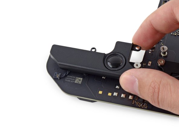

  27. Mac mini Late 2014 Speaker Replacement: 步骤 27 中的图像 1,2 Mac mini Late 2014 Speaker Replacement: 步骤 27 中的图像 2,2
    • Do not attempt to remove the speaker entirely as it is still attached to the logic board.
    • Nudge the speaker gently out of the way to allow access to the speaker's connector.
  28. Mac mini Late 2014 Speaker Replacement: 步骤 28 中的图像 1,3 Mac mini Late 2014 Speaker Replacement: 步骤 28 中的图像 2,3 Mac mini Late 2014 Speaker Replacement: 步骤 28 中的图像 3,3
    • Use the flat end of a spudger to carefully lift the speaker connector up out of its socket on the logic board.
    • Remove the speaker from the logic board.
