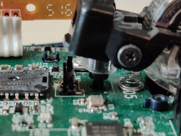

  4. Logitech Mouse MX Anywhere 2 microswitch Replacement, Remove the wheel: 步骤 4 中的图像 1,3 Logitech Mouse MX Anywhere 2 microswitch Replacement, Remove the wheel: 步骤 4 中的图像 2,3 Logitech Mouse MX Anywhere 2 microswitch Replacement, Remove the wheel: 步骤 4 中的图像 3,3
    • Start by removing the 2 screws holding the plastic bridge, circled in blue in the first photo.
    • remove the lone screw on the front of the wheel (circled in yellow on the 2nd photo)
    • You can now lift the wheel assembly out, making sure you also take the front black plastic screw guide with it.
    • NOTEL there is also a spring attached below the wheel assembly.

  6. Logitech Mouse MX Anywhere 2 microswitch Replacement, Desolder and replace the faulty click switch: 步骤 6 中的图像 1,3 Logitech Mouse MX Anywhere 2 microswitch Replacement, Desolder and replace the faulty click switch: 步骤 6 中的图像 2,3 Logitech Mouse MX Anywhere 2 microswitch Replacement, Desolder and replace the faulty click switch: 步骤 6 中的图像 3,3
    在这个步骤中使用的工具:
    Desoldering Pump
    $3.99
    • The click switch as 3 pins (boxed in red). I replaced the left button mouse switch only as the right one is still working.
    • I had to prime the solder, by adding some fresh solder to each pin in order to get the circuit solder to melt and loosen the pins.
    • I clamped the board and used a small flat screwdriver as a lever below the switch to gently pry it away while I heated each pin.
    • I used a desoldering pump to clean the circuit holes
    • the original Omron switch is made in China, and I managed to find one made in Japan, hoping for better life-time.
