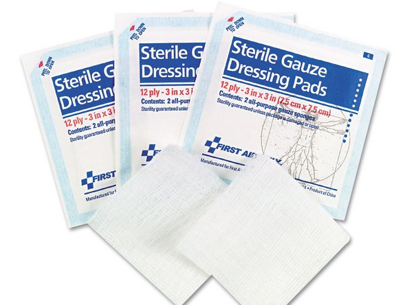

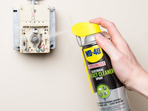

    3. Logitech MX Master 3 pairing problem solving, If the problem reappears: 步骤 13 中的图像 1,3 Logitech MX Master 3 pairing problem solving, If the problem reappears: 步骤 13 中的图像 2,3 Logitech MX Master 3 pairing problem solving, If the problem reappears: 步骤 13 中的图像 3,3
      • Clean the first end of the flat flexible cable and test if the pairing problem disappears. If the issue is resolved, reassemble your mouse and enjoy a reliable connection. If not, proceed to clean the next end of the cable in sequence until the problem is fixed.
      • Use a gauze pad dipped in an electrical cleaning solution to clean the ends of the flat flexible cable (FFC).
