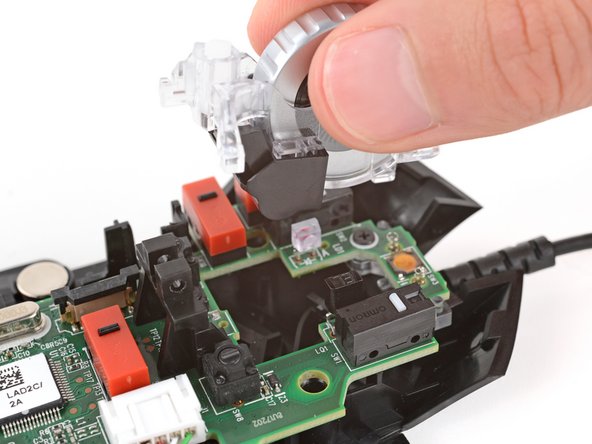

  18. Logitech G502 Hero Scroll Wheel Replacement, Remove the scroll wheel: 步骤 18 中的图像 1,3 Logitech G502 Hero Scroll Wheel Replacement, Remove the scroll wheel: 步骤 18 中的图像 2,3 Logitech G502 Hero Scroll Wheel Replacement, Remove the scroll wheel: 步骤 18 中的图像 3,3
    • Use the point of a spudger to push out and remove the locking pin from the plastic scroll wheel support in the center of the motherboard.
    • During reassembly, insert the locking pin so the curved end is facing down.
  19. Logitech G502 Hero Scroll Wheel Replacement: 步骤 19 中的图像 1,3 Logitech G502 Hero Scroll Wheel Replacement: 步骤 19 中的图像 2,3 Logitech G502 Hero Scroll Wheel Replacement: 步骤 19 中的图像 3,3
    • Gently pull the scroll wheel towards the front of the mouse and lift to remove it.
    • Be careful not to lose the two small springs near the front of the mouse.

Where did you get the scroll wheel replacement part?
Drew - 回复
I upgraded my scroll wheel with one from a Logitech Performance MX. The wheel itself was only $8 on eBay.
Well worth the upgrade, since the stock one feels cheap. Dunno if the Master mice wheels are compatible, hopefully someone can chime in.
brandon - 回复
If you're suffering from a stuttery wheel response, be sure to check inside the wheel before you buy a replacement. Mine had a tiny ball of fluff that had formed inside the wheel that was interrupting the sensor, I removed that and it's good as new again. Thanks for the great guide.
Alan - 回复
Can confirm. I took the wheel out and cleaned the inside and also the clear plastic that it sits in and now it's working normally again.
