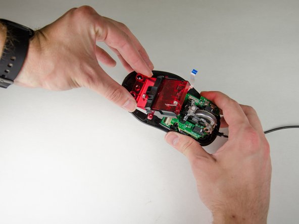

  4. Logitech G500 Cord Replacement: 步骤 4 中的图像 1,1
    • Now, or at any time, you may wish to remove the weighted cartridge inside of the mouse. It is best if you do it at or before this step, but it is not necessary.
  5. Logitech G500 Cord Replacement: 步骤 5 中的图像 1,1
    • With all screws removed, carefully pry the top of the mouse away from the body.
    • There is a cable securing the top of the mouse to the body. Do not remove the case too far or this may break.

  7. Logitech G500 Cord Replacement: 步骤 7 中的图像 1,2 Logitech G500 Cord Replacement: 步骤 7 中的图像 2,2
    • Remove the three Phillips screws to free the weight cartridge holder.
    • Lift the weight cartridge holder from the body.
