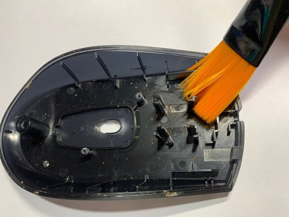

  6. Logitech G1 Optical Mouse Scroll Wheel Replacement: 步骤 6 中的图像 1,2 Logitech G1 Optical Mouse Scroll Wheel Replacement: 步骤 6 中的图像 2,2
    • Clean the mouse case, lid, and module with a dry cotton swab or soft brush.
    • Potential for device damage: Do not use water or an iron brush to clean it.
