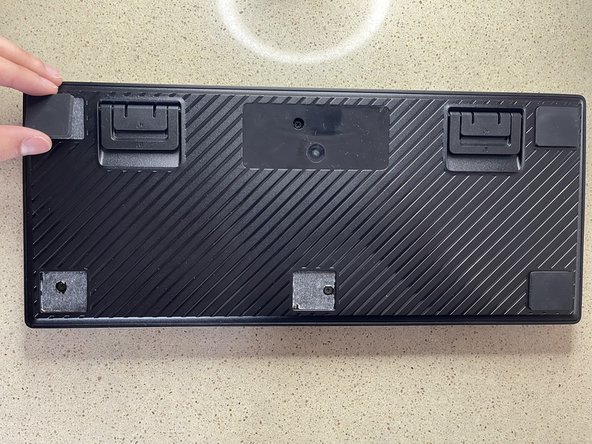

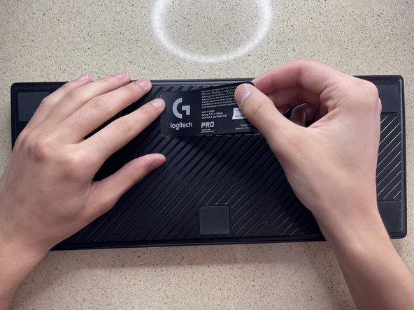

    • Flip the keyboard and lay it face down.
    • Remove the Logitech sticker and all of the rubber feet by peeling them away slowly. This allows the screws holes to be shown.

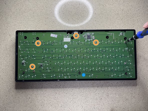

  5. Logitech G PRO Keyboard Romer G Switch Replacement: 步骤 5 中的图像 1,2 Logitech G PRO Keyboard Romer G Switch Replacement: 步骤 5 中的图像 2,2
    • Remove the four 6.4 mm screws using a Phillips #1 screwdriver.
    • Remove the four 3.8 mm screws using a Phillips #1 screwdriver to separate the board from the top case.

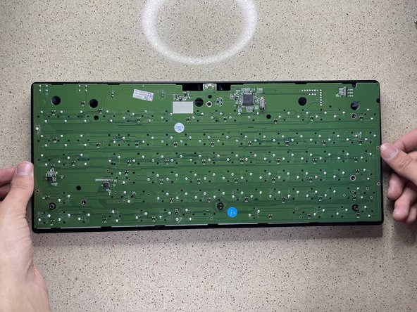

  6. Logitech G PRO Keyboard Romer G Switch Replacement: 步骤 6 中的图像 1,3 Logitech G PRO Keyboard Romer G Switch Replacement: 步骤 6 中的图像 2,3 Logitech G PRO Keyboard Romer G Switch Replacement: 步骤 6 中的图像 3,3
    • Gently press on the black casing around the board to let the top casing fall away from the board.
    • Lift the board out of the top casing and place the top of the case to the side.
