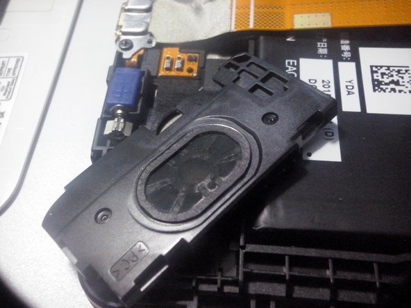

    • In my tablet the speaker is hold in place by tabs, very easy to remove.
  4. LG G Pad F 7.0 LK430 LCD Display Touch Screen Digitizer Glass Assembly Replacement: 步骤 4 中的图像 1,3 LG G Pad F 7.0 LK430 LCD Display Touch Screen Digitizer Glass Assembly Replacement: 步骤 4 中的图像 2,3 LG G Pad F 7.0 LK430 LCD Display Touch Screen Digitizer Glass Assembly Replacement: 步骤 4 中的图像 3,3
    • Remove the speaker and the vibration motor in order to expose the ribbon cable beneath. All the components sport contact connectors, very nifty.
    • Carefully peel away the tape, in order to remove the ribbon cable. Remove the two screws you see in the picture.

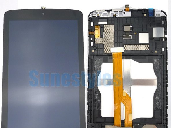

  7. LG G Pad F 7.0 LK430 LCD Display Touch Screen Digitizer Glass Assembly Replacement: 步骤 7 中的图像 1,1
    • There are now several US and Chinese Ebay sellers offering the whole assembly, so you basically only have to reconnect the ribbon cables, put the screws in place and enjoy your tablet again. I ordered item 172233283111.
