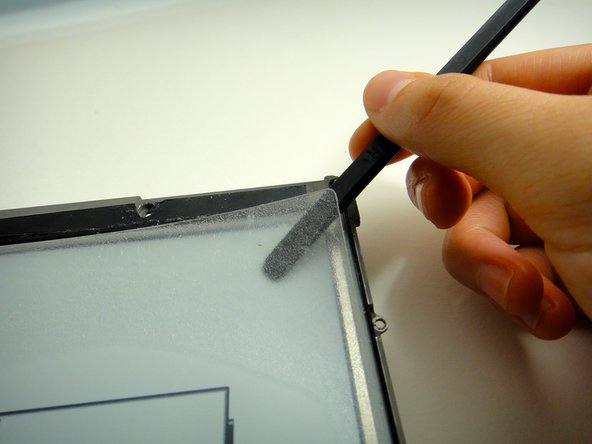

    • Use a pair of tweezers to remove the white strip of tape that covers the LED lights.
  12. Kindle Paperwhite 1st Generation LED Lights Replacement: 步骤 12 中的图像 1,2 Kindle Paperwhite 1st Generation LED Lights Replacement: 步骤 12 中的图像 2,2
    • Use a spudger to gently remove the plastic screen from the display.
    • The plastic screen is held on by a thick layer of glue. Be patient when lifting the screen to avoid bending or breaking the thin plastic.
  13. Kindle Paperwhite 1st Generation LED Lights Replacement: 步骤 13 中的图像 1,1
    • Once the outer screen is removed from the Kindle, gently use your fingers to pull off the LED lights.
