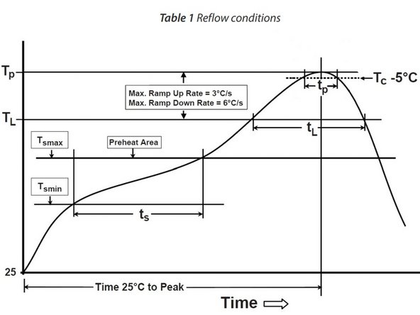

    • To disassemble to receiver, grip both ends of the receiver with pliers then pull to separate.
    • Remove the PCB from the receiver plastics and ensure there is no residual plastic remaining on the PCB.
    • Solder flux may be applied at this stage to help with the reflow process.
    • Place the PCB in a temperature resistant tray/container. The PCB will be heated to ~500 degrees Fahrenheit, ensure the container can withstand this level of heat.
  1. How to reflow Logitech G602 Receiver, Reflow the PCB: 步骤 4 中的图像 1,2 How to reflow Logitech G602 Receiver, Reflow the PCB: 步骤 4 中的图像 2,2
    • Reflow according to the attached information following as closely as possible to avoid damage. Use a thermometer to track your progress if using a standard heat gun. Make sure not to exceed the maximum temperature and apply even heating to the PCB.
    • Note: When reflowing if too much heat is applied to the edges of the PCB the PCB can begin to delaminate.
    • Note: Reflow profile follows Nordic Semiconductors guidelines. Nordic Semiconductor is the manufacturer of the SoC Transceiver used in this device.
    • Optional: If using a reflow oven set profile according to the attached documents.
    • Optional: This can be performed in a standard kitchen oven, though this is not recommended unless the PCB is sealed in an airtight container to prevent potentially toxic gasses from escaping and depositing inside the oven.
    • Allow the PCB to cool and reassemble the device.
    • Once the device is cooled and assembled, test your connection to the receiver using the Logitech receiver connection utility.
